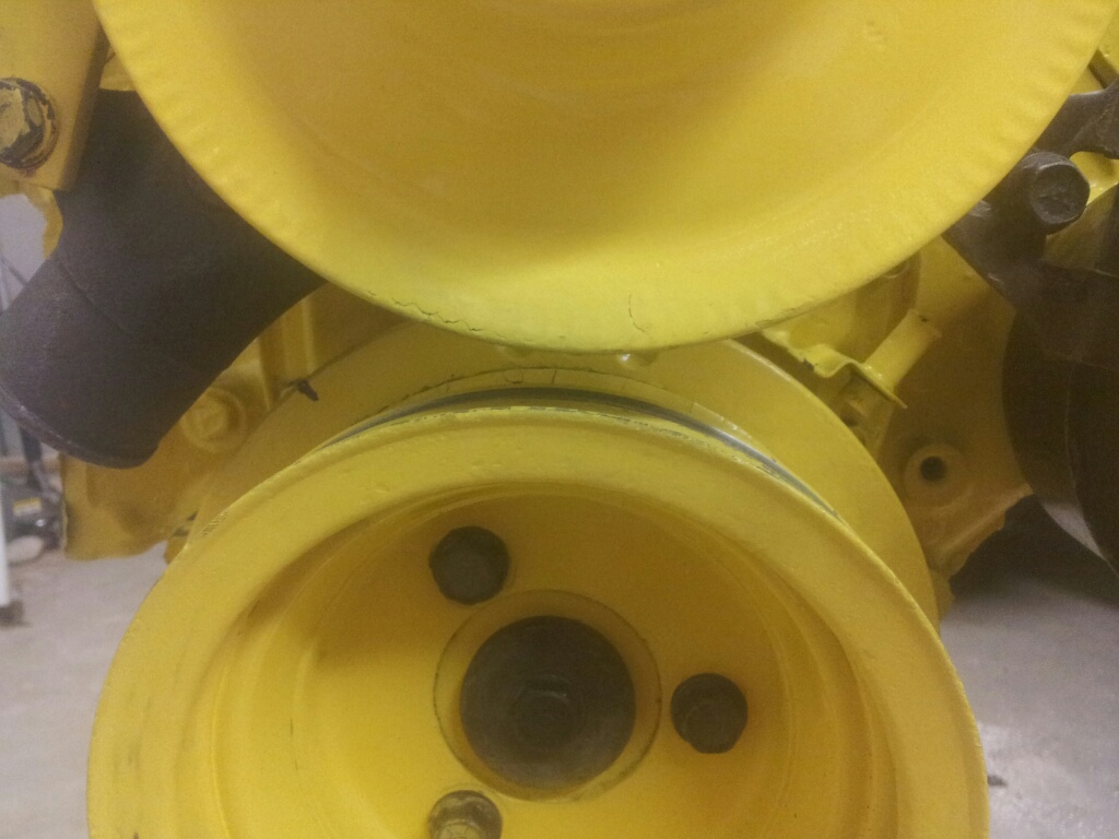

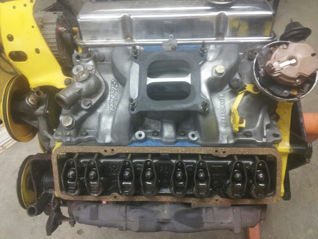

I made sure I was on a compression stroke (air pushing out) and went far enough to line up the timing marks but that puts the dist like this:

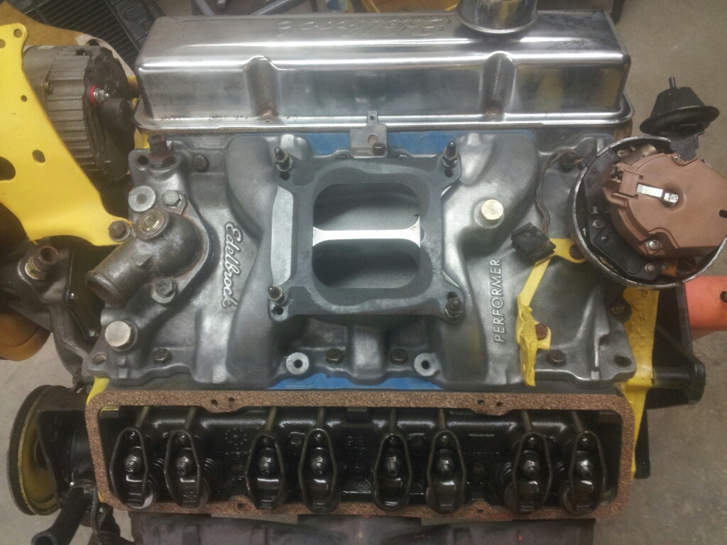

That didn't look right to me so I turned the engine back enough to point at #1 like so:
That puts the timing mark over towards 10 o'clock like this:
Do I have the dist stabbed in wrong, looking at the wrong things, or maybe the harmonic balancer has slipped? :dunno:

you need to put the motor back at the first pic and restab it back a tooth.. you'll need a long flatblade to turn the oil pump drive...
technically, you could just leave it as-is in the first pic and just lace it from where the rotor is pointing... people place WAY too much importance on the rotor pointing towards the #1 cylinder.. it really doesn't mean d*ck... yes, it's nice to have it set up that way, BUT it can run fine pointing in any direction as long as it's laced properly...
mentioned it before... look at the dopey move gas monkey did... eh, just rip all the plug wires off and put new ones on without notating what was going where... idjit...
You can put it back the way it was and just move the number one plug wire over 1 spot clockwise. Then you will have about 20 degrees of adjustment again. As long as its a tdc you will have it on compression and the plug wire in the correct spot where the rotor is pointing it will run the same as if it was pointing at number one. Or you can testable the distributor again. It looks one tooth off if you're worried about it.
