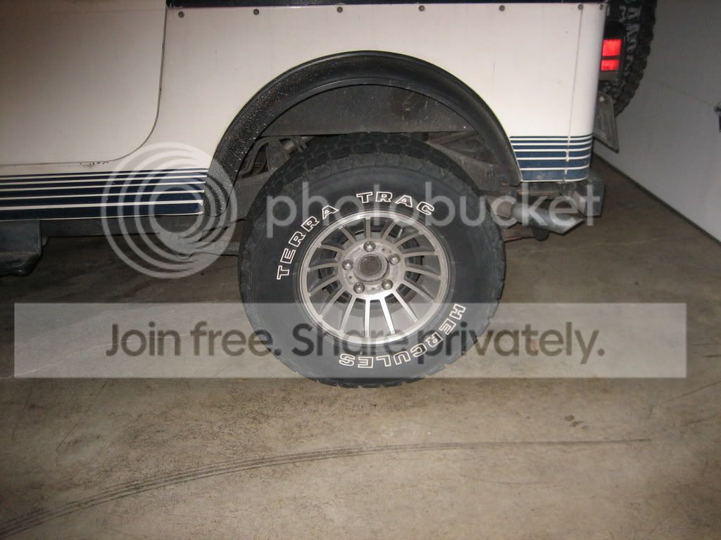

i found these in the local paper classifieds.....75.00.......they are western wheel, polished out side of the finns, just not too clean.
