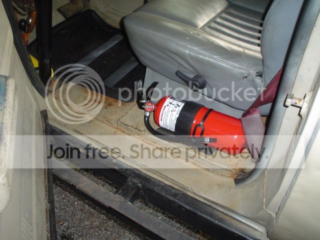

How would you fasten a fire extinguisher mount into the floor above the gear box: sheet metal screws or bolts?
I'm thinking sheet metal screws aren't strong enough - what do you reckon?
Both of mine are held in with sheet metal screws
Thanks guys - metal screws are good enough for me. I wasn't sure about their suitability for the weight of the fire extinguisher (small type, about 10" height). As you know, in a crash, that fire extinguisher can become a dangerous projectile, so I didn't want it to pop off too easily. Anyhow, it'll be mounted on the floor, so there will be no weight on it.
Where do you guys have your fire extinguisher mounted? For me here in the hot desert, it's a must.
I used 4, 1/4 x 20 bolts to hold mine in place. I would have used sheetmetal screws but i have about 10,000 1/4 x 20's in the garage. I won them in a Gov auction for $35.
I need it to be as visible as possible - so if I say: "go get the fire extinguisher in the truck" it's right there as they open the door.
