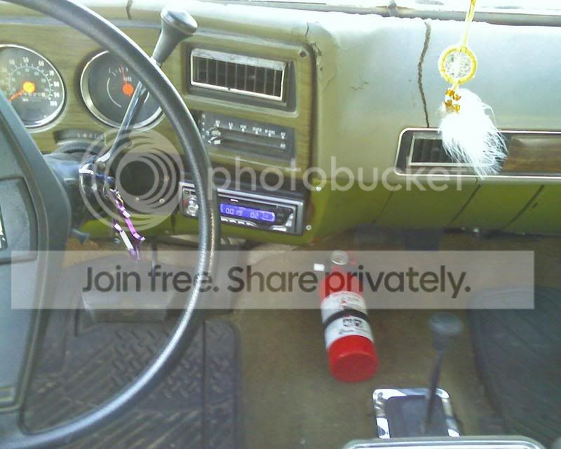

if you have a speaker behind the seat i set it up right there so if i have to jump out of my truck i can still reach it with ease and i know its right there..bought it for like 10 bucks at p&a when i was there..have a few more in the garage too

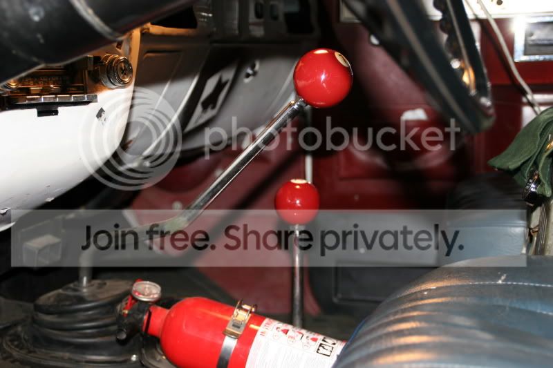

not a great pic, but it's mounted to the tranny hump next to the 205's shifter.
