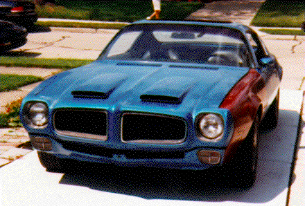

I really want a 70 to 73 Formula Firebird with the dual hood snorkle scoops.
