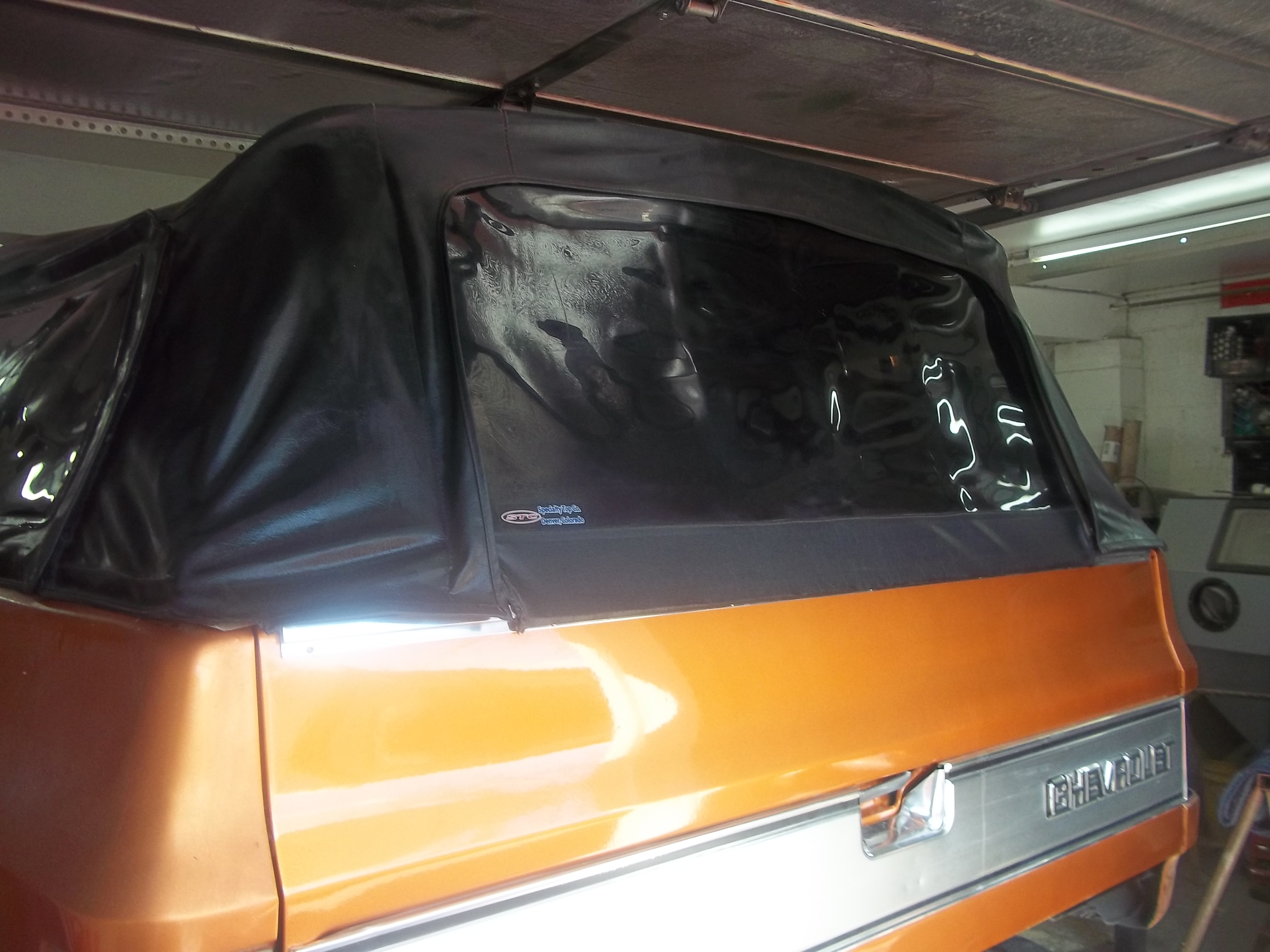

Hey guys, just at picked up a ‘90 V10. The tailgate is looking like more trouble than it is worth and I’ll most likely run a soft top anyway. Live in SoCal, so weather isn’t a concern.
Question: is there a truck tailgate that I could swap out?
I’m going to paint her eventually and already need to replace the driver’s side door and fender.

i run one on my K5.. as said, just get the hardware with it...
