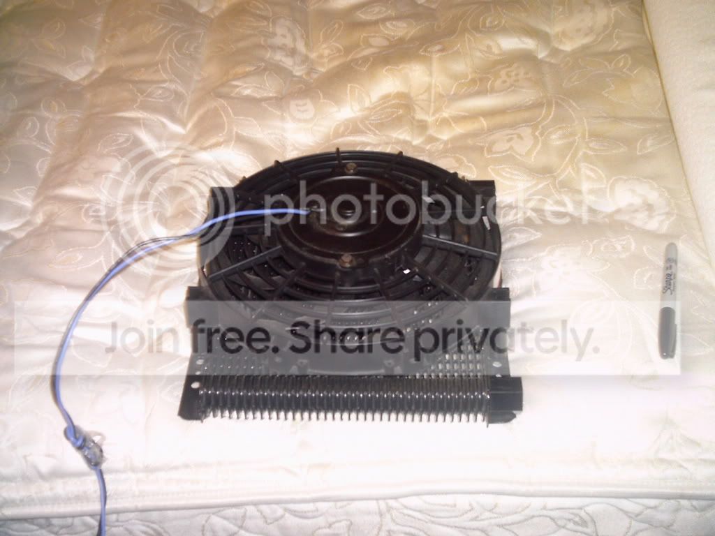

i got my cooler yesterday....its got a fan and its decent size...will this be satifactory for full hydro??
Mine is about that size, I don't have a fan but its mounted in front of the radiator so I'm sure it has air being pulled past it. It cools my system very well.
i hooked the fan up to my battery when i got it just to make sure it works and it moves ALOT of air...ive bought the cheapest part now for the expensive stuff..
I don't even have a cooler on mine.

Run the system without a cooler at first. If the fluid exceeds 190 degrees easily then you will want to plumb a cooler into the return line. It should not be a stacked plate cooler but instead a fin and tube cooler or straight through design. The tube and fitting size of the cooler should be at least -8 size if not larger.
