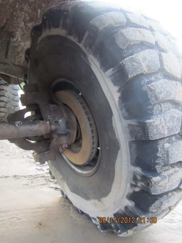

My 1990 K5 is ground for 15" wheels. I drove it from California to Nebraska.

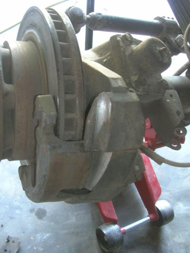

One time on the river I broke a stub shaft, and it exploded my lockout and got into the wheel bearings. I drove for awhile, and then lost the bearings. The only thing holding the wheel on was the caliper and caliper mounting bracket. I drove it a mile and a half off the river this way, and onto a trailer.
This is what it looked like when I got home. You can see the wheel did some additional grinding. I installed a new stub shaft (35 spline), new lockout, new bearings/races/seals, but I am still using that caliper and mounting bracket.
So I don't put a lot of stock into people who say it weakens them.....

No idea. I bought it that way, and it had 16" wheels on it when I got it. I didn't realize they were even ground till I got home with it. I have done several Dana 44's though. The Dana 60 requires a lot more grinding.
