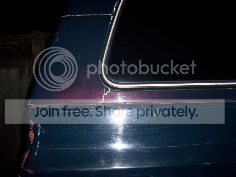

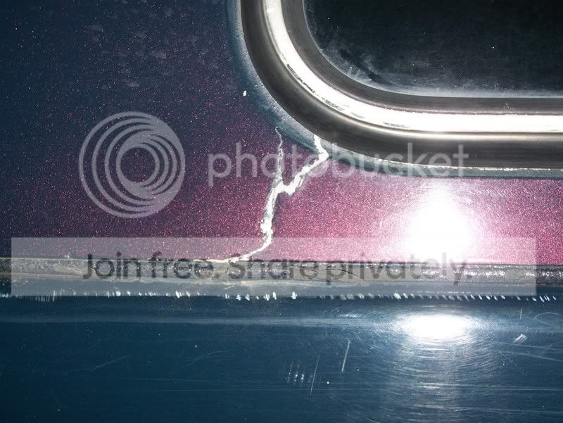

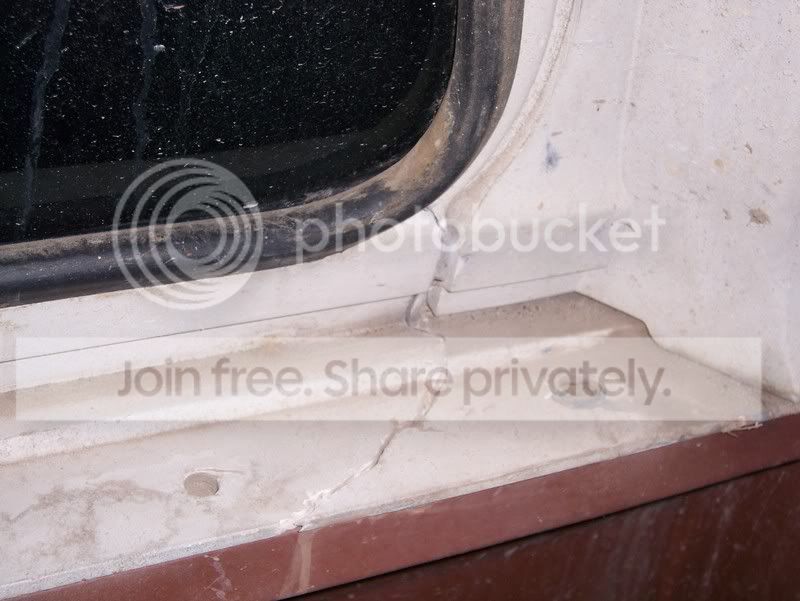

these pics are the same crack. and it's like this on both sides...
sorry, i don't know how to resize the pics, and i know that the top and body are different colors, i plan to do the whole truck camo after awhile

I'll wait and see what those who fiberglass have to say, but with it all the way through like that, I'd expect it might take some time, especially to make good, and as strong as it was factory.
These things typically crack/separate where the seams are in the rear, and yours did crack through a seam, no idea if it started there or not. In any case, I would have to imagine for any repair to be strong enough to withstand the flexing the top goes through, you will need to fix the seam as well.
