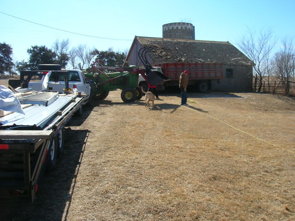

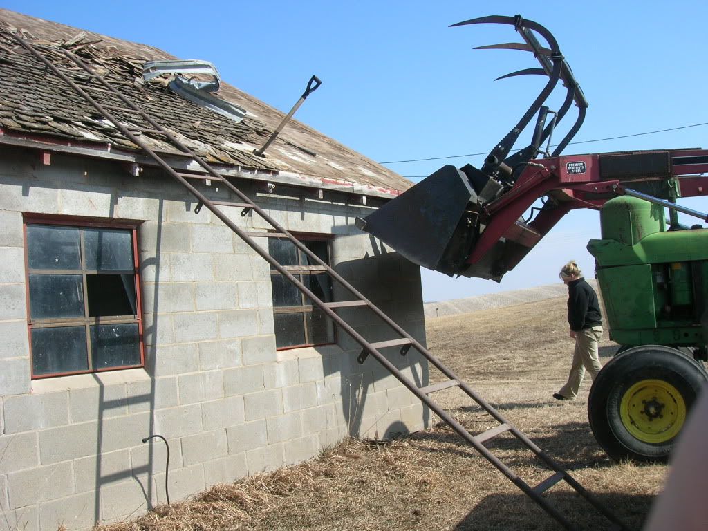

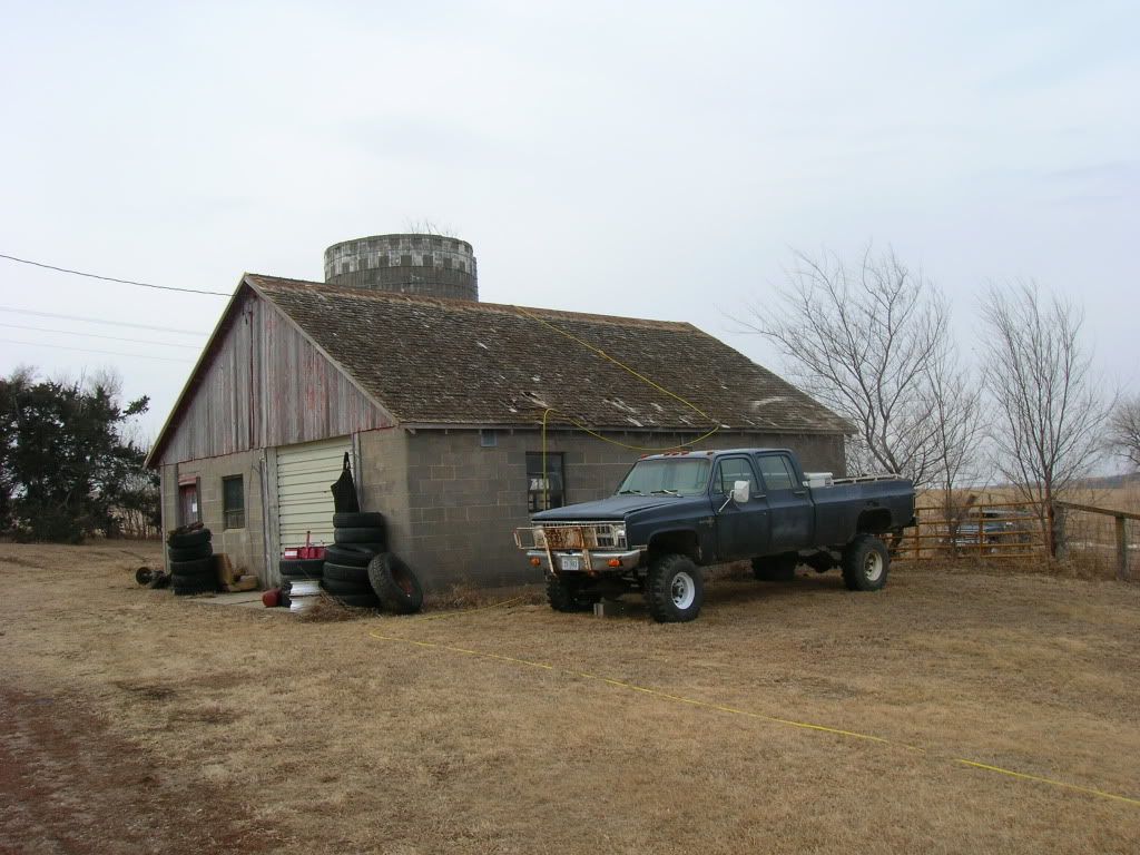

The first day of working on it, my buddy Joe came up and he gave me his old digital camera. These are just a few random pictures of that first day, tearing off the old shakes, and getting ready to tin the roof.

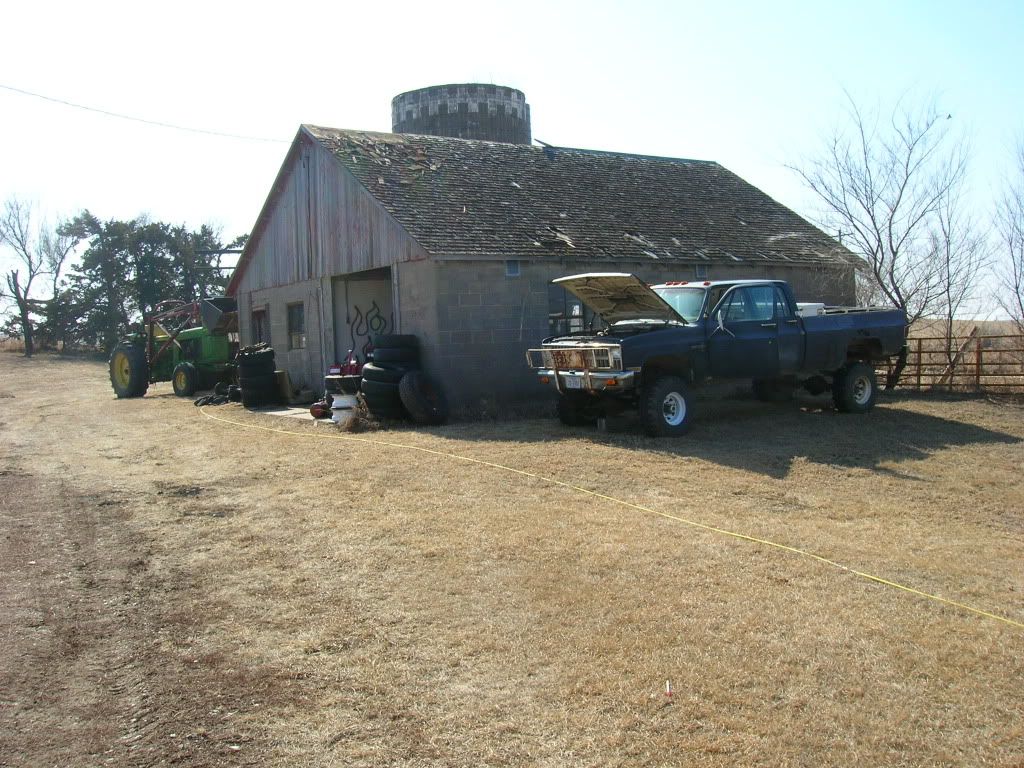

The shakes were beyond shot. You could see daylight through many places in the roof.
Luckily the old 1"x12" sheeting underneath was still in pretty good shape.

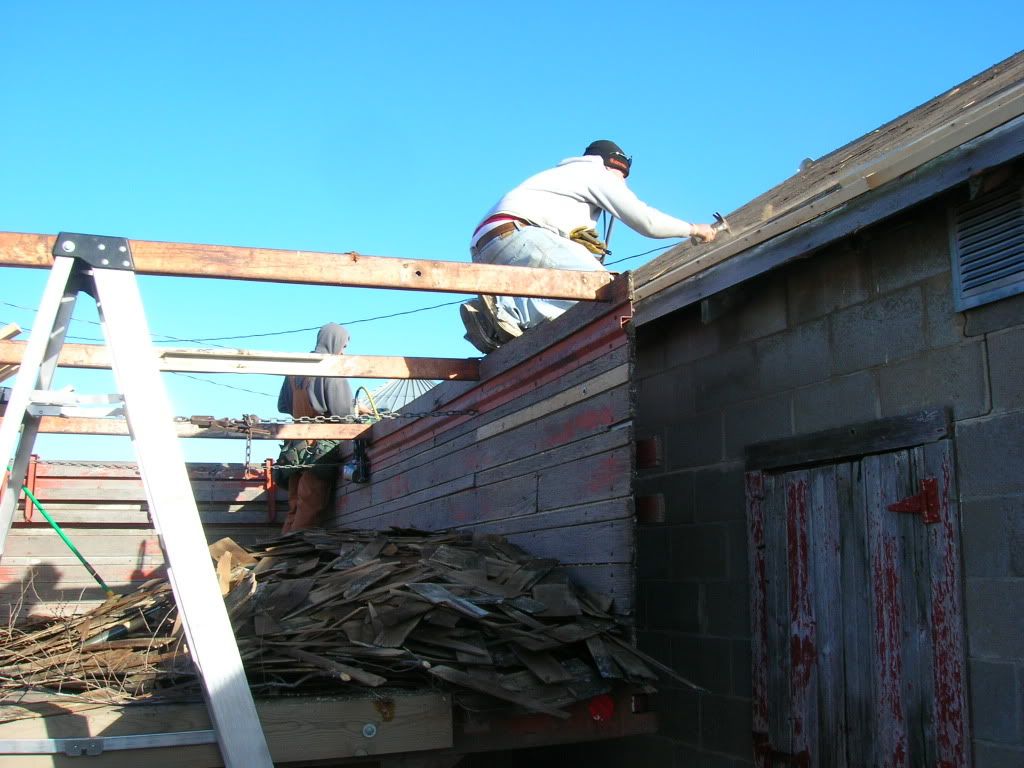

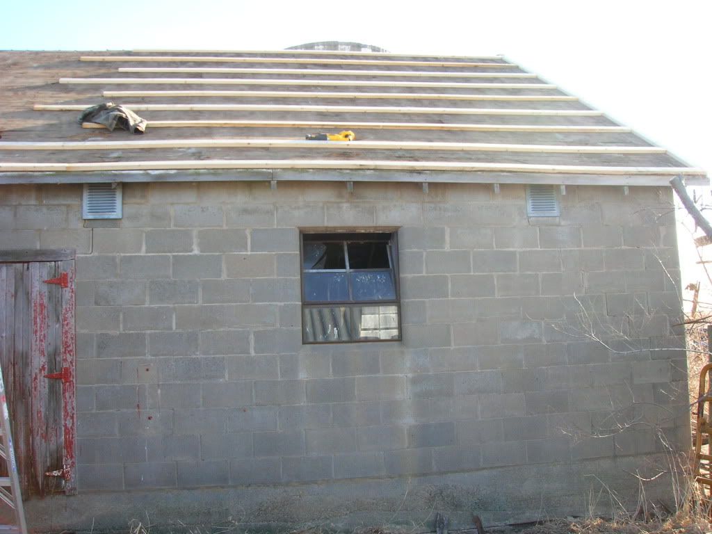

That was all I took the first day. Stopping to take pictures just doesn't cross my mind when I am working on something. We ended up working on it until after nightfall. Got all of the shake torn off, and then ran 2"x4" stringers across the roof to have something to screw the tin down to, and make it so that you were able to walk around on the roof. That pitch is steeper than it looks.

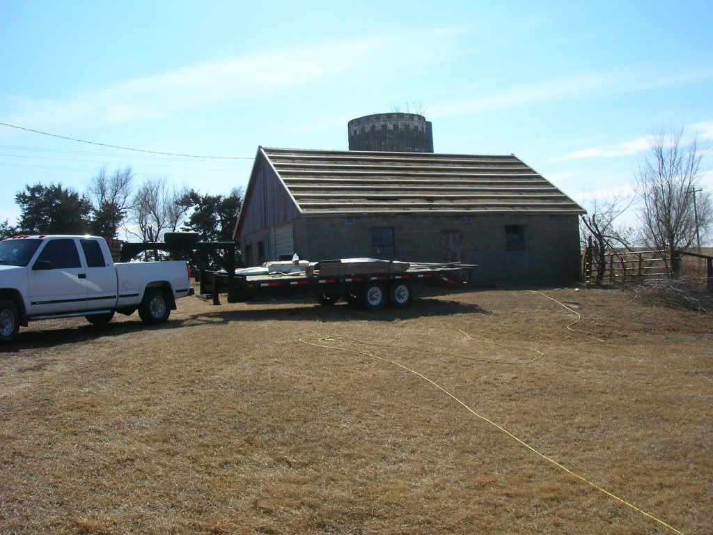

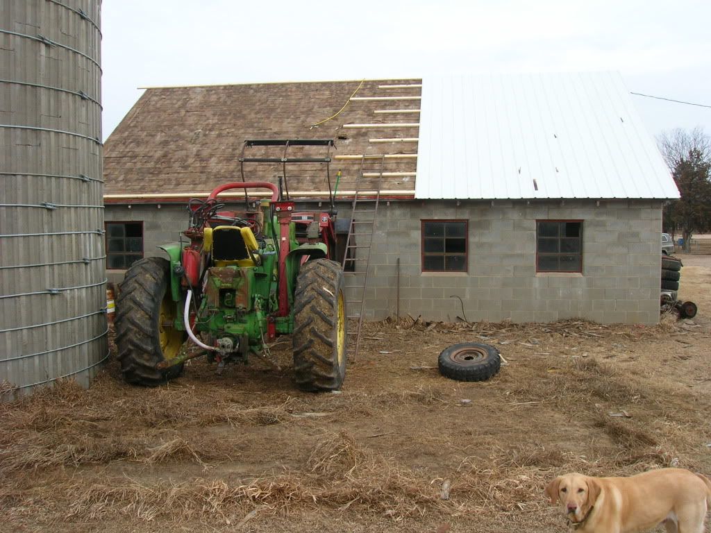

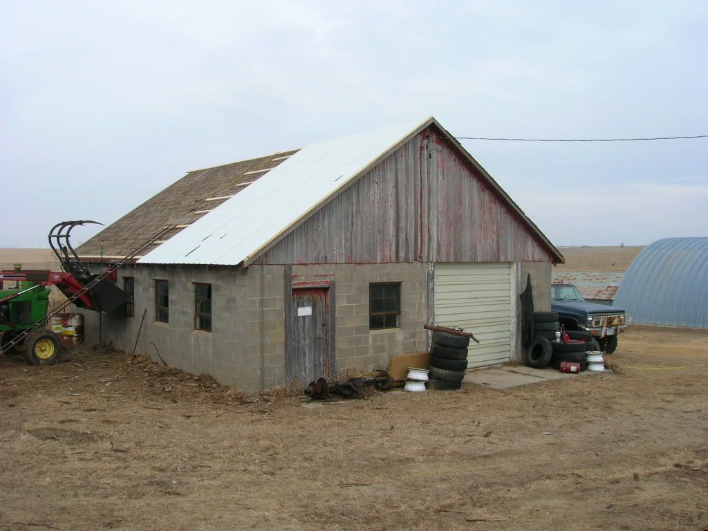

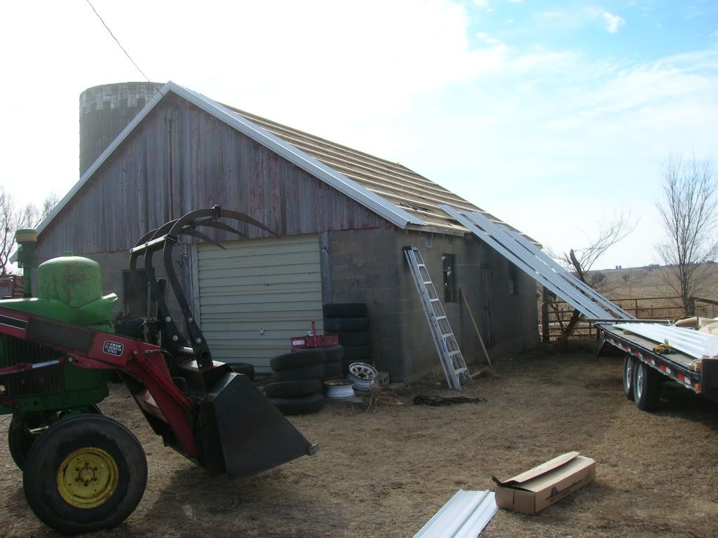

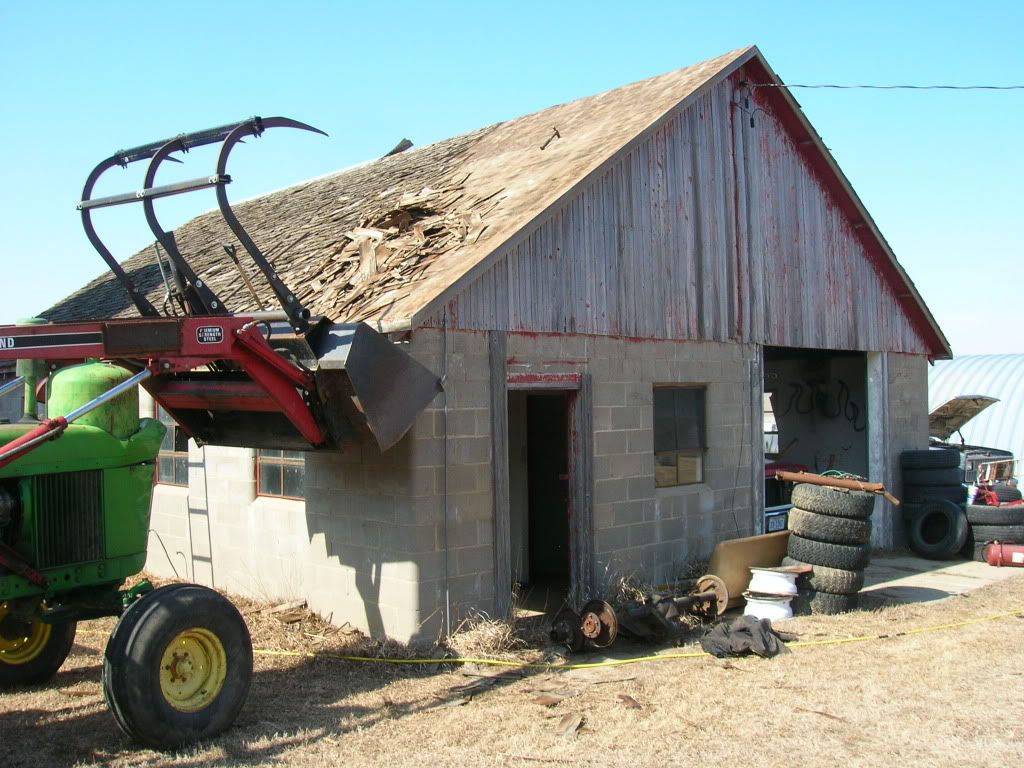

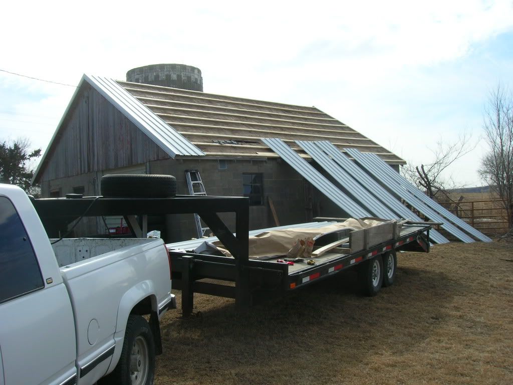

Her is how it looked the next day. The wind blew really hard that day, so we didn't try to hang 18' long pieces of tin. My air compressor was down in the quonset, so we ran 200' of air hose up to the milk barn.
You can see some of the shakes from the North side that blew over onto the new tin on the South side.

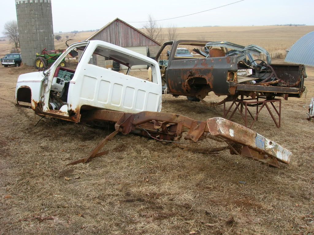

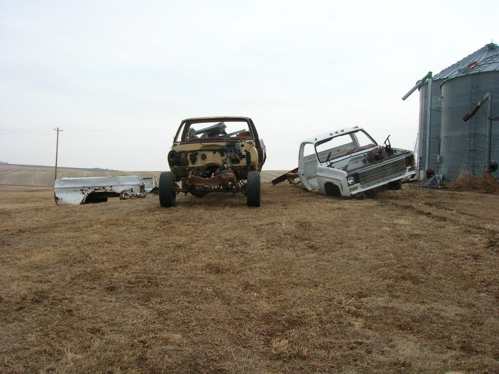

We moved the two parts trucks out of the way to make room for the 4020LP.
Here is where we drug them to. Not much left of them, need to haul them in for iron.

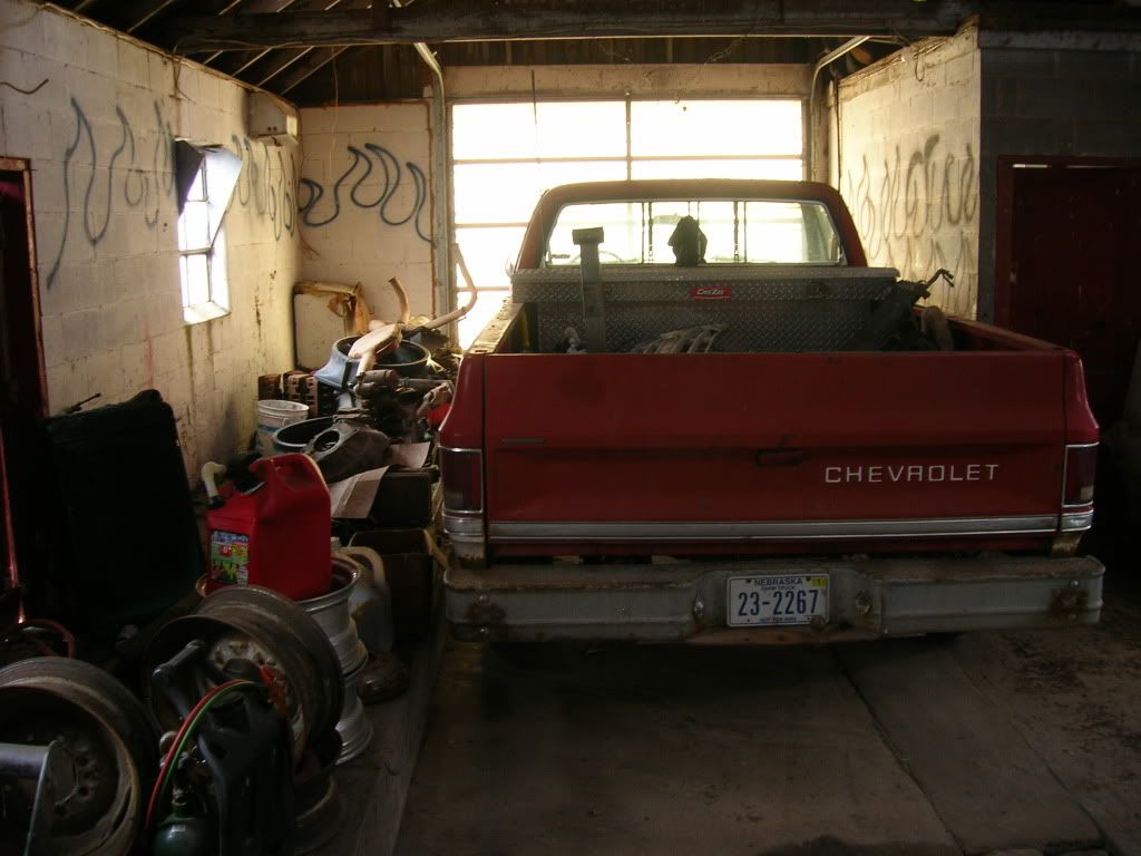

Paid $100 for the brown 1981 K10. It had a blown 350 and a good SM465/NP208 combo in it with a set of 3.08:1 axles. I sold the rear axle to some other kid for $100. The funny part was I hauled the truck home from a couple hours away, and the kid that ended up buying the axles only lived a couple of miles from where I got it from. Paid $200 for the white 1979 K20, it had a 4.10:1 geared Dana 44/14bff combo in it.

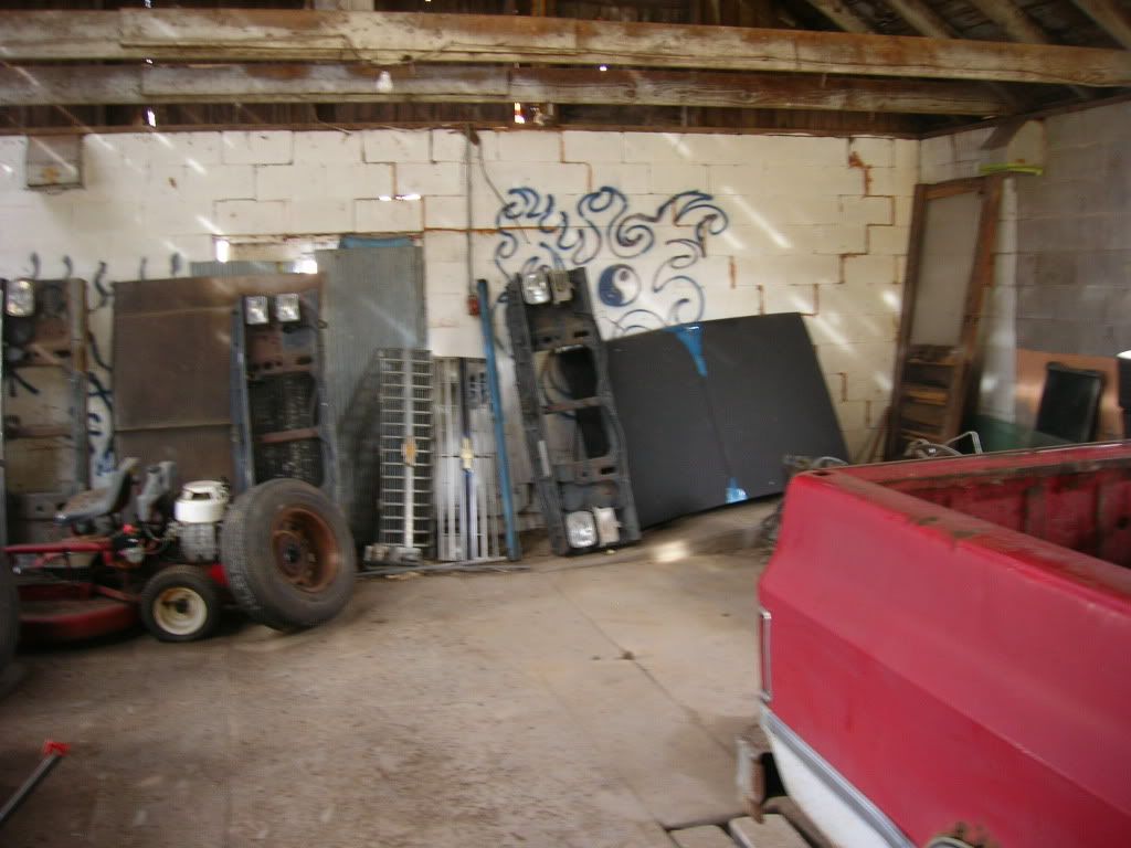

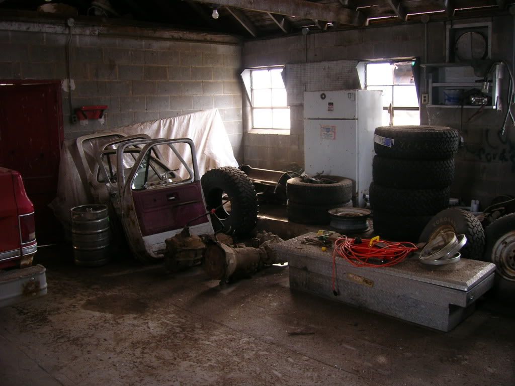

Here are some pictures of all the random junk I had inside of it. Pay no attention to the stupid flames, those were from the former tenant.

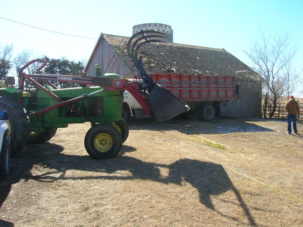

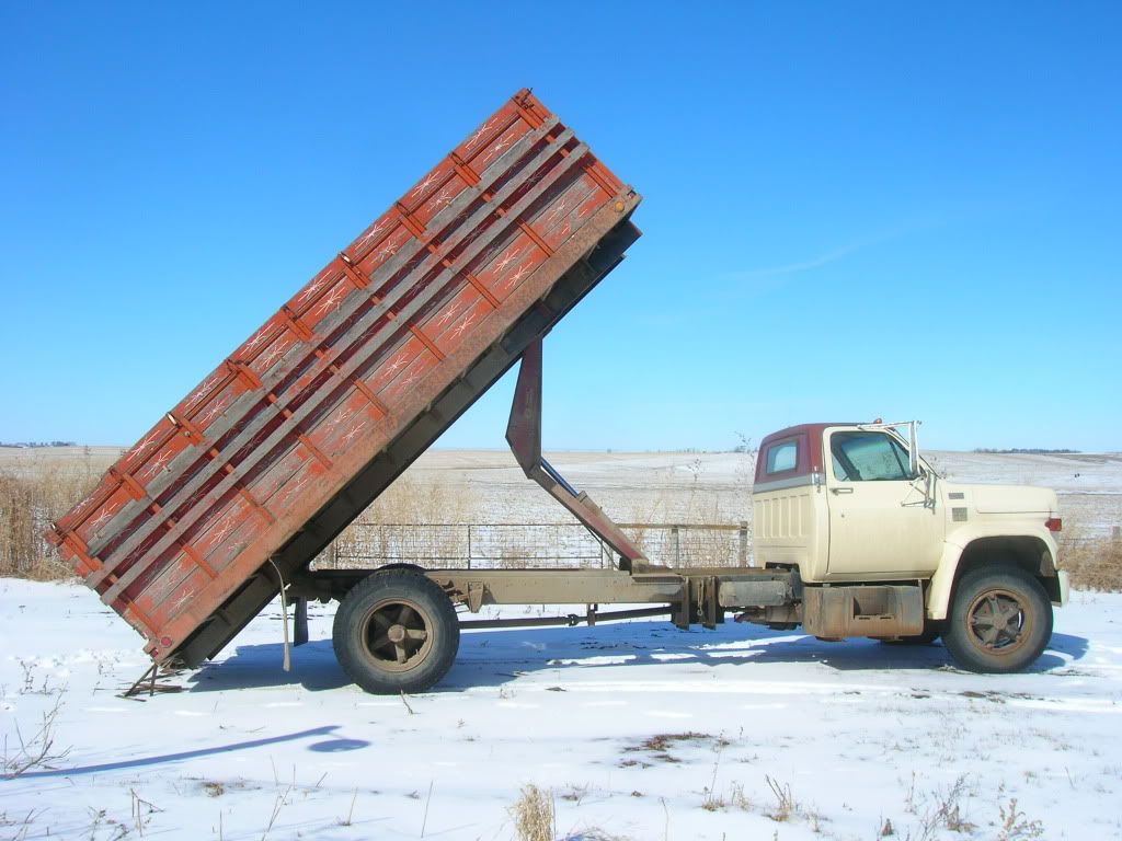

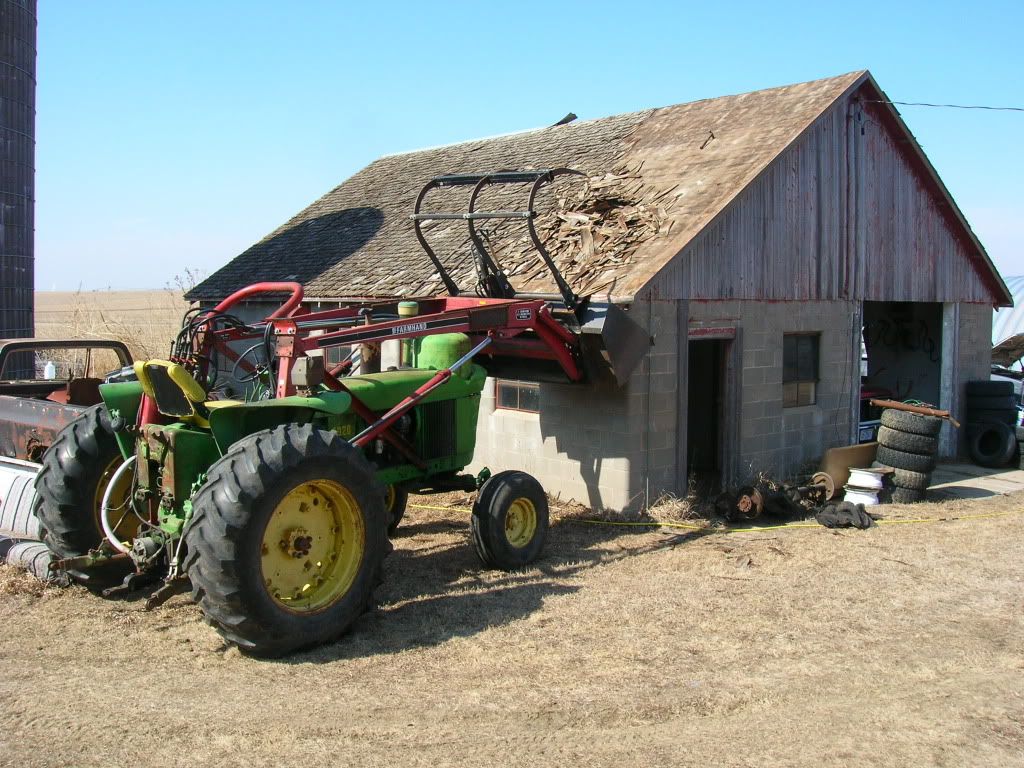

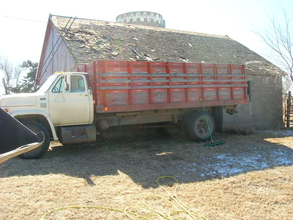

The following day the wind went back down and we got back to work. I even conned the old man into coming down and helping that day. The North side of the roof is a little higher up from the ground, so we were able to drive the 1976 C65 straight truck under the eve and rip the shakes off into it. Much easier that way.
That is the world's heaviest ladder I am pretty sure. It is off the old West grain bin that we don't use any more.

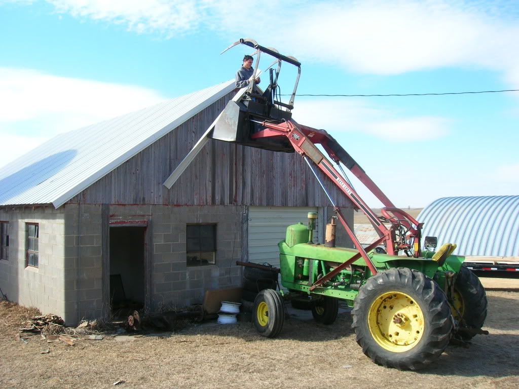

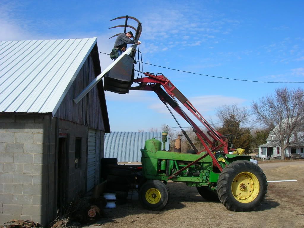

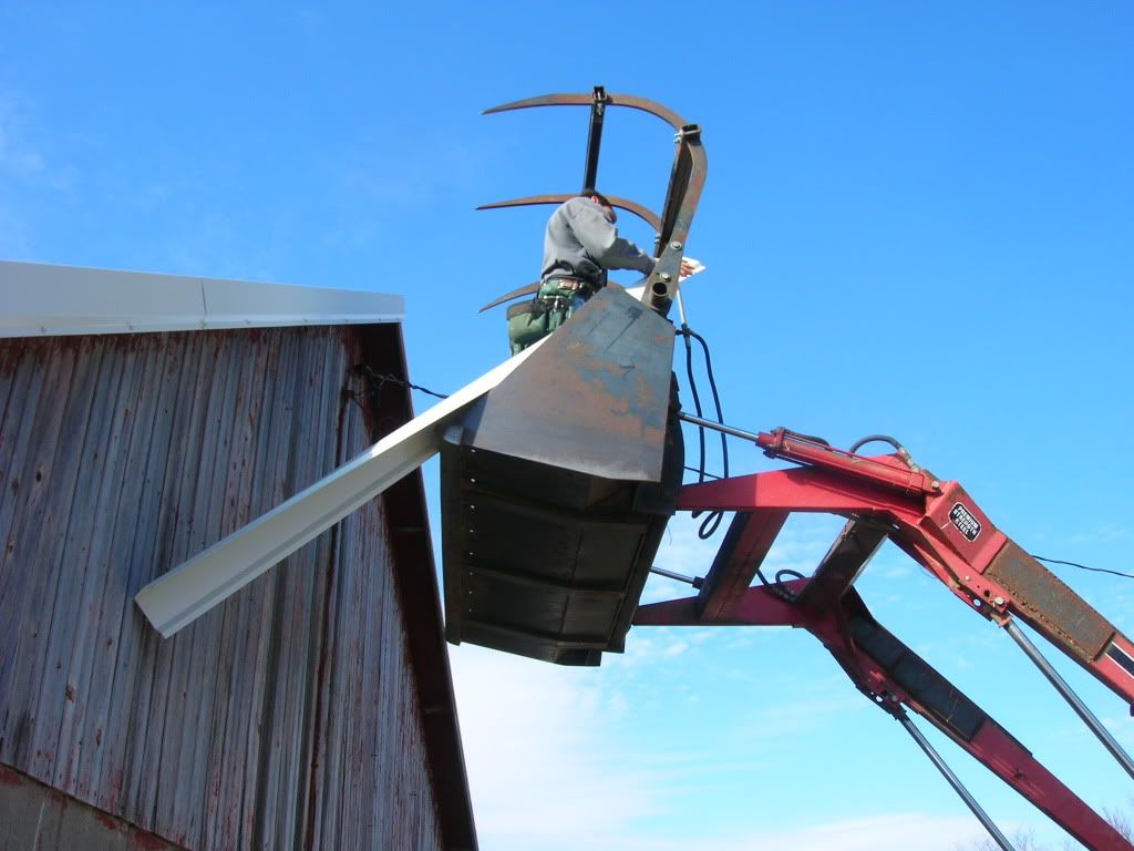

Pedro in the loader bucket, installing the trim.
The old Farmhand loader gets up there a ways.
I thought he did a pretty nice free handed cut on the peak.
It was just the two of us Sunday afternoon, so I had to set all of the sheets up along the building, to eliminate climbing up and down every time.
At least we had a little better ladder this day.

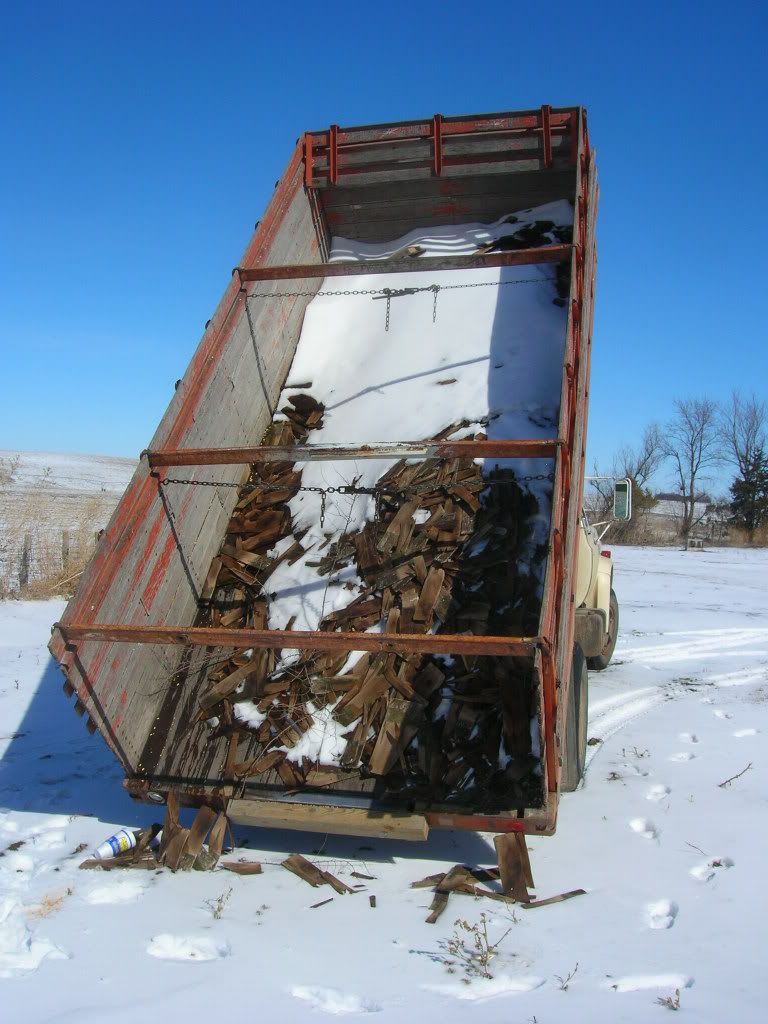

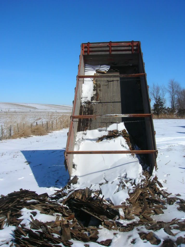

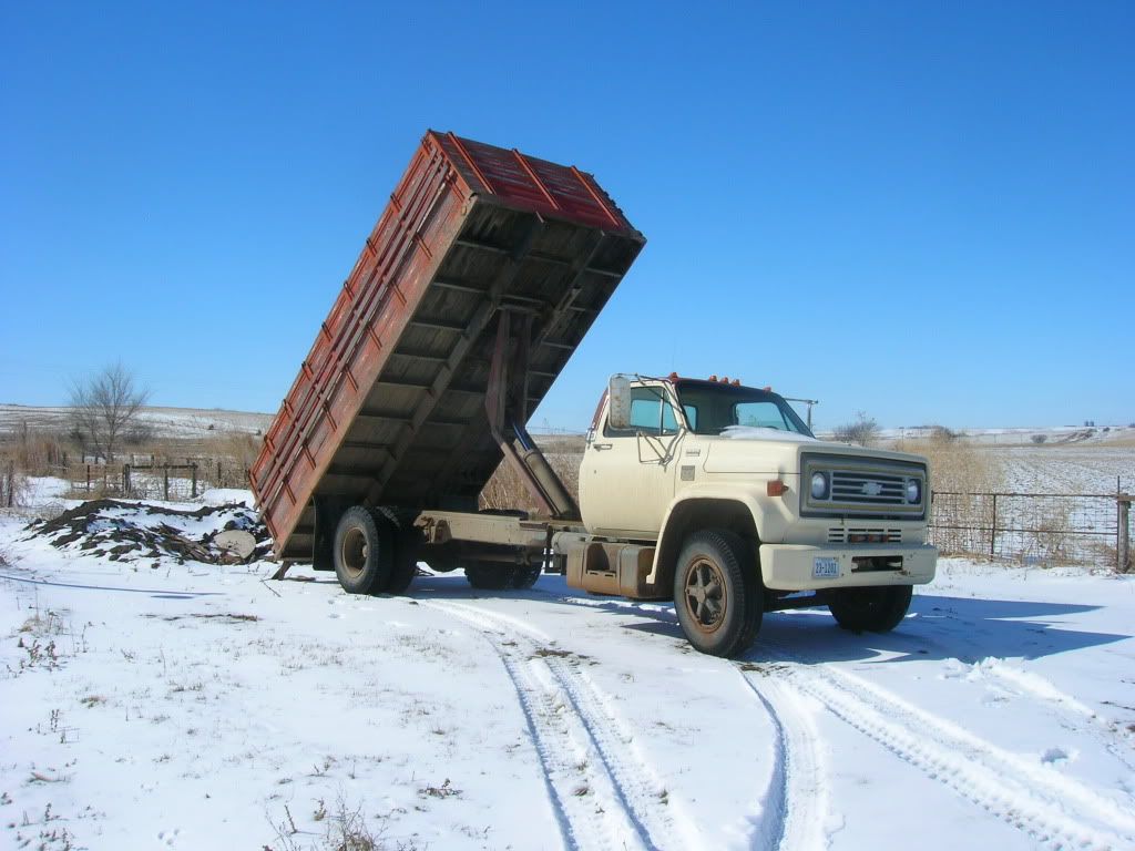

Dumping the old shakes into the burn hole.
They were stuck in there due to the snow, but it was thawing out, so I just left the truck sit there for a few hours.
Came back later and just backed up a couple feet, and out they came.

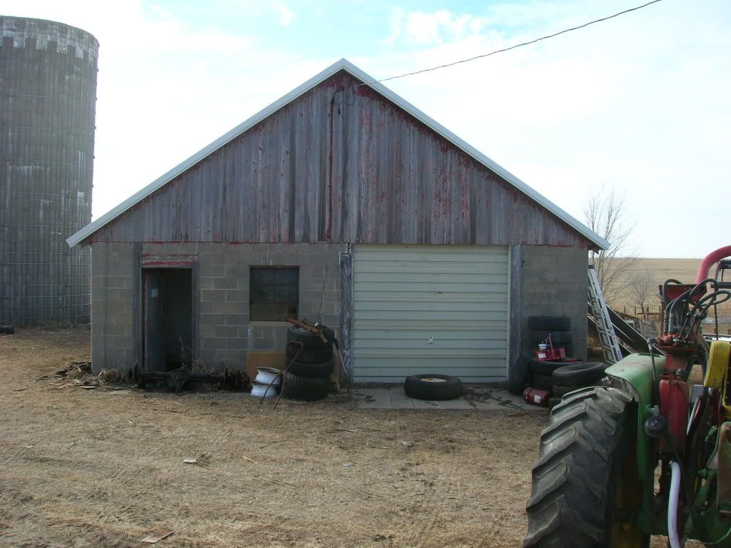

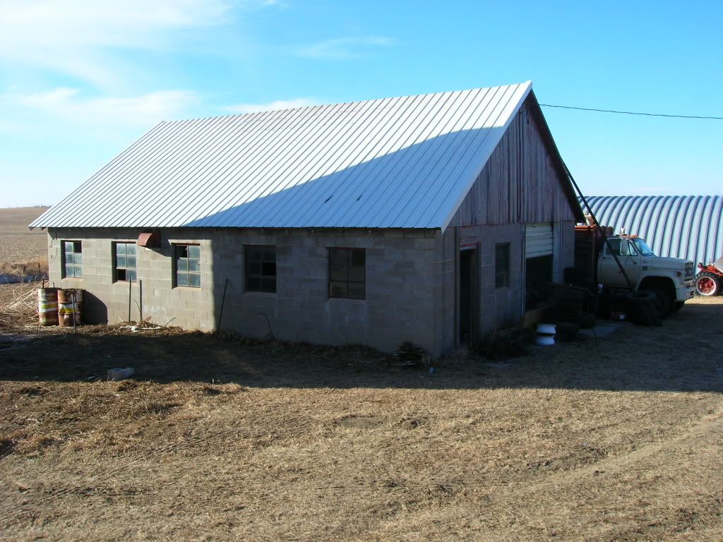

Finished product. Well the roof at least. It still needs a lot more work.

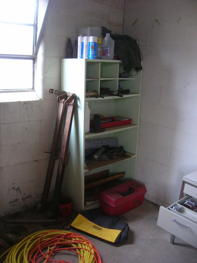

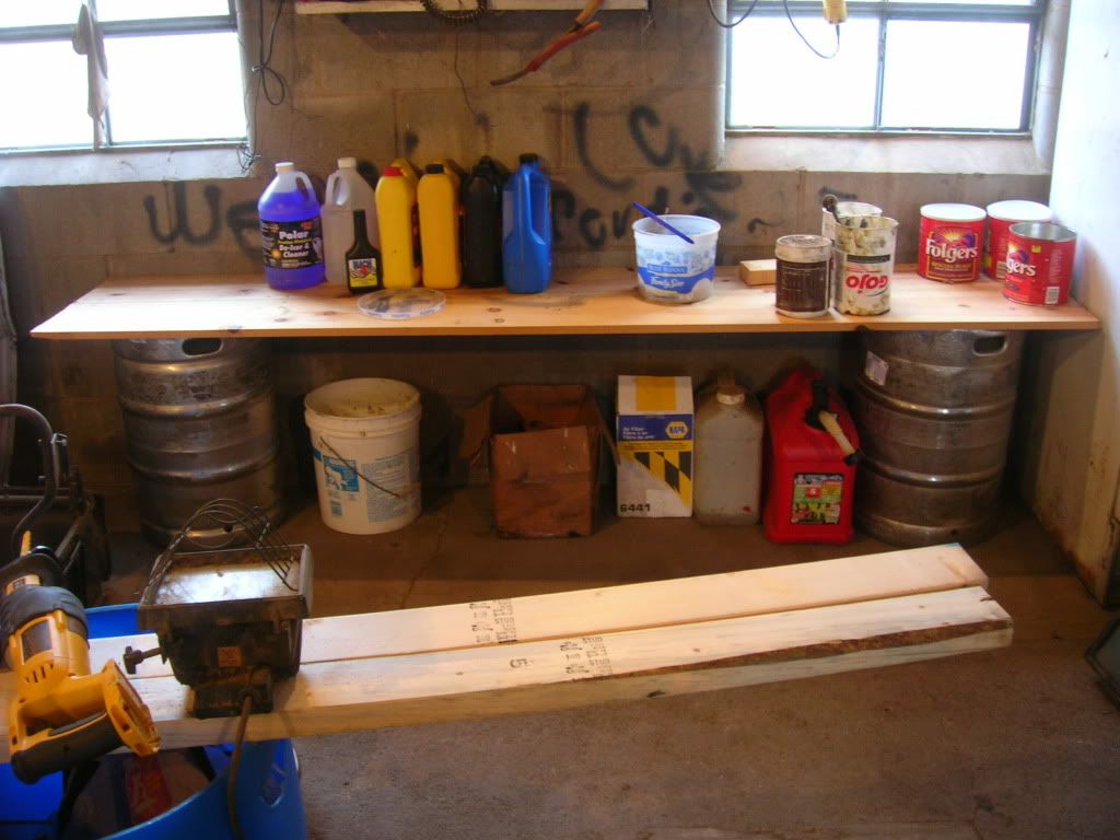

Here is a quick shelf I built. Had the lumber laying around, and a few old keg shells. I found out today that a 15.5 gallon keg, is 15.5" across.

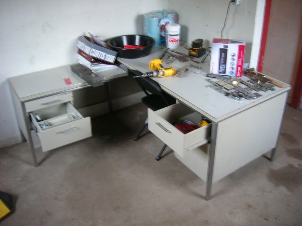

I got this old metal desk for free. Wouldn't mind finding a few more. It should make a decent light duty work bench, and the drawers have some decent rollers on them, so they should work good for storage.
Another freebie. I am not sure why anyone would want this in their house anyway, but it will work fine for me.

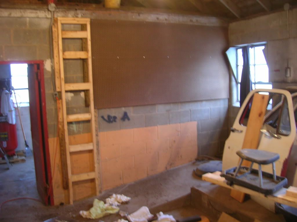

I hung that piece of pegboard today. After I took this picture, I took it back down, and ran a 4th stringer behind it, and put it back up. Should work good for the cheaper tools I don't keep in my tool box. The ladder I also built today to gain access to the loft area on top of the old parlor. Once I got up there I found a ton of junk the previous tenant left behind. Some of it good stuff, most of it junk. There was a crack free dash for a 1973-1980 Chevrolet pickup up there, but he had set something on it, and smashed it, so it got burnt. Too bad really.
Another shot of the ladder I built. It may not be square, or pretty, but it is pretty damn stout.

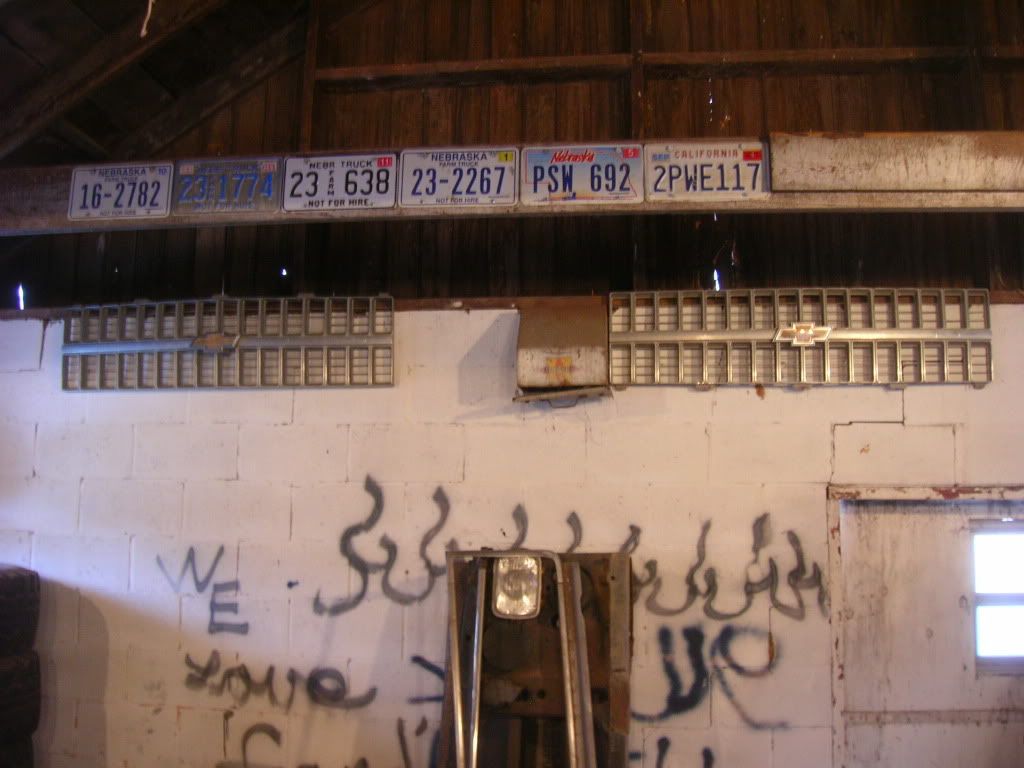

A place to hang old license plates. I wonder what it would cost to ship old license plates here from out of state? I am sure some of you guys have old ones you would be willing to get rid of? I also found some old nails on the back wall that made a convenient place to hang old grilles.
