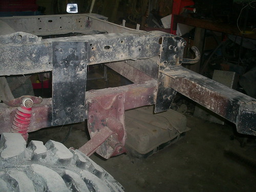

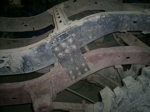

He has stacked frame. It looks crazy. Not sure of the point, but I give him credit for being different. Just doesn't look too strong to me.

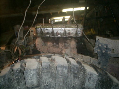

Its not the trans tunnel. Its the space the saddle tanks occupy in a pickup. The doubler shouldnt need floor clearance in this truck as the frame is 3" taller than a blazers. Also I can build the floor to clear it as Im not going to do the floor until the drivetrain is done.
that's...different. :thinking:
I bet that adds a whole lot of weight, even though the front is chopped out. actually, that's sort of weird, too. i'd trust it more if the supports/connecting points were boxed instead of just flat steel. To each his own.
My doubler hit under the floor of my seat with a 1 inch body lift, the 205 is rotated up a few inches.
