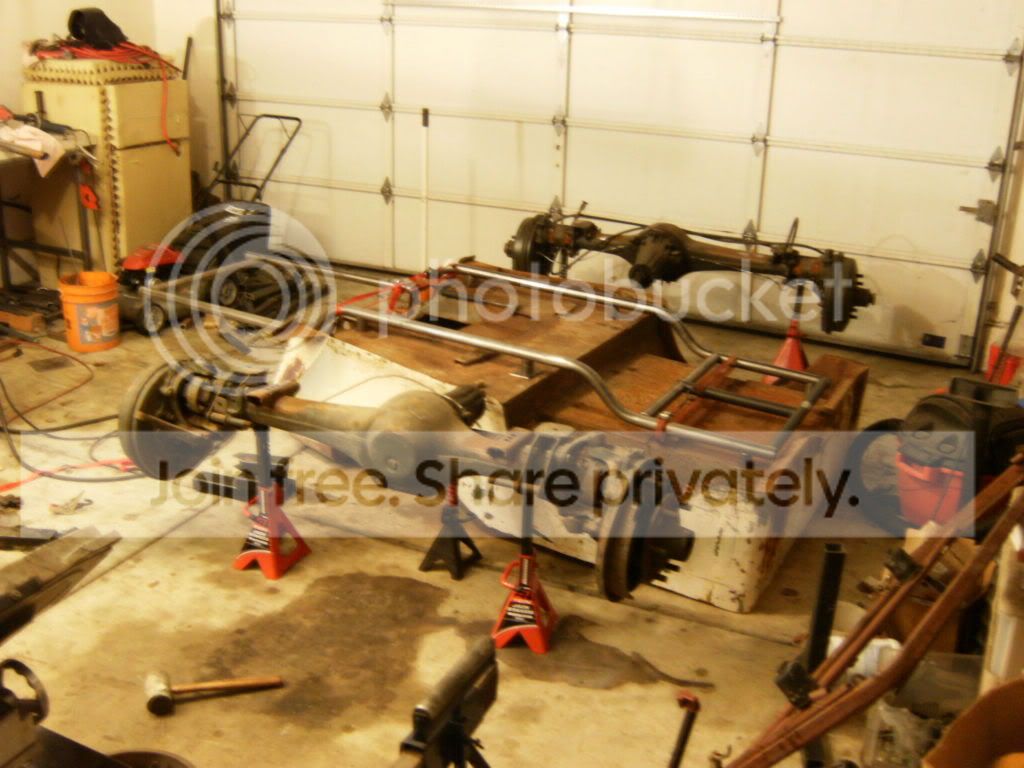

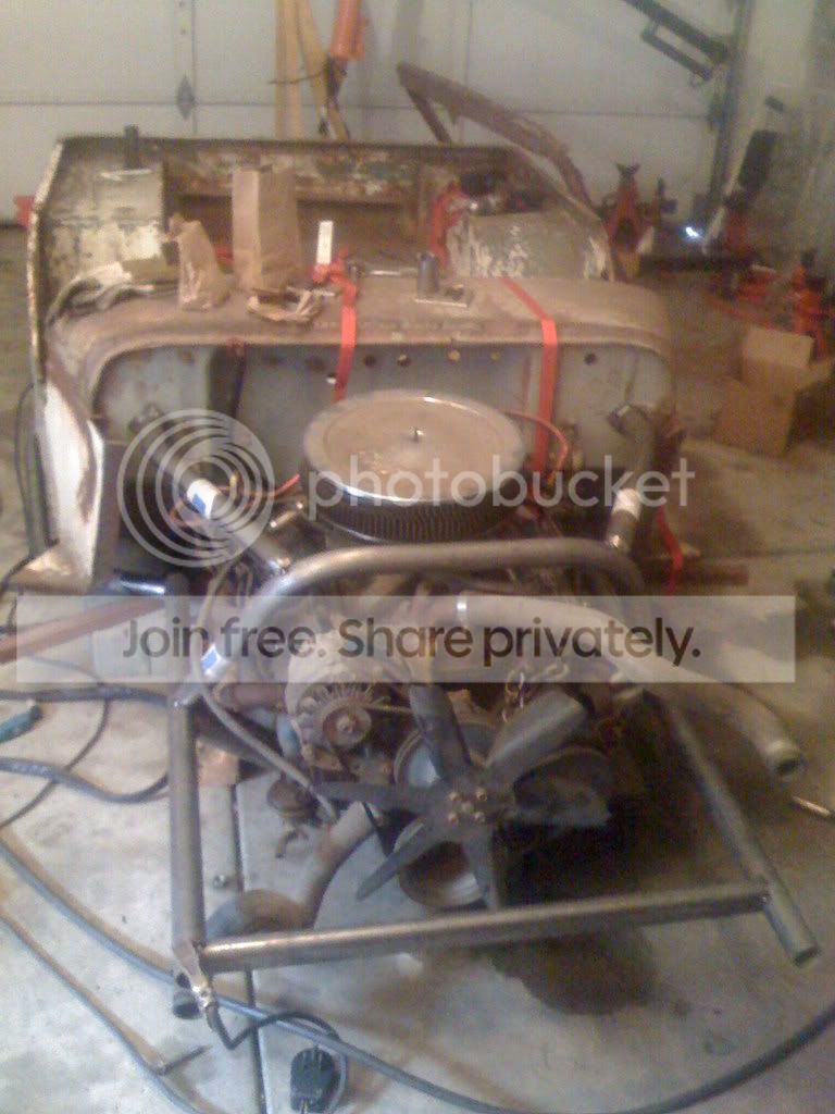

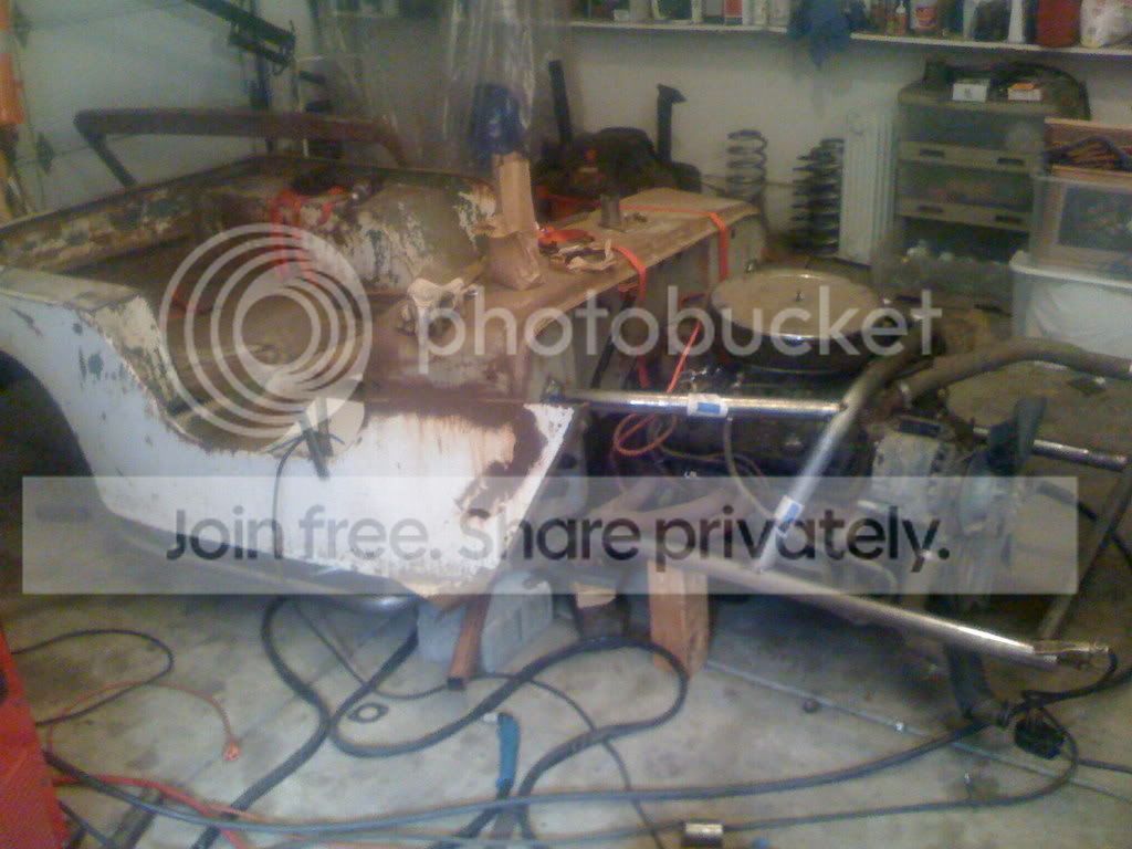

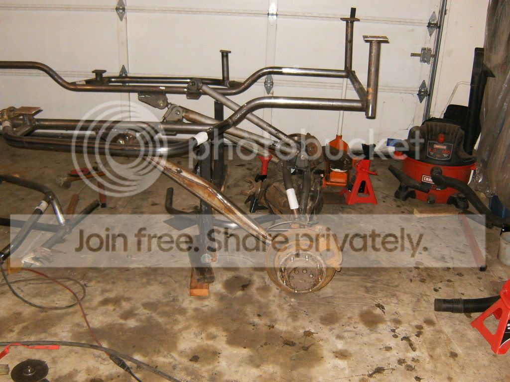

here's the run down...i actually started this thing about three months ago. it started with unimog 404 portals and 42's. i decided to downsize cause i wanted a smaller wheeler. found a reproduction willys body for 300 bucks made of 1/8" sheetmetal! so now here she lies:
gmzz4 crate motor with hot cam and roller rockers (400+ horse)
built 700r4 tranny
tcase= n/a
14 bolt rear with disc's 5.13's detroit
dana 44 front 5.13's chromo's warn hubs locker=n/a

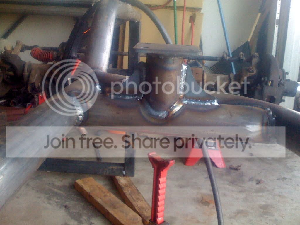

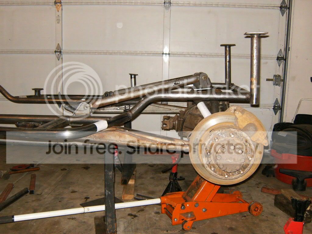

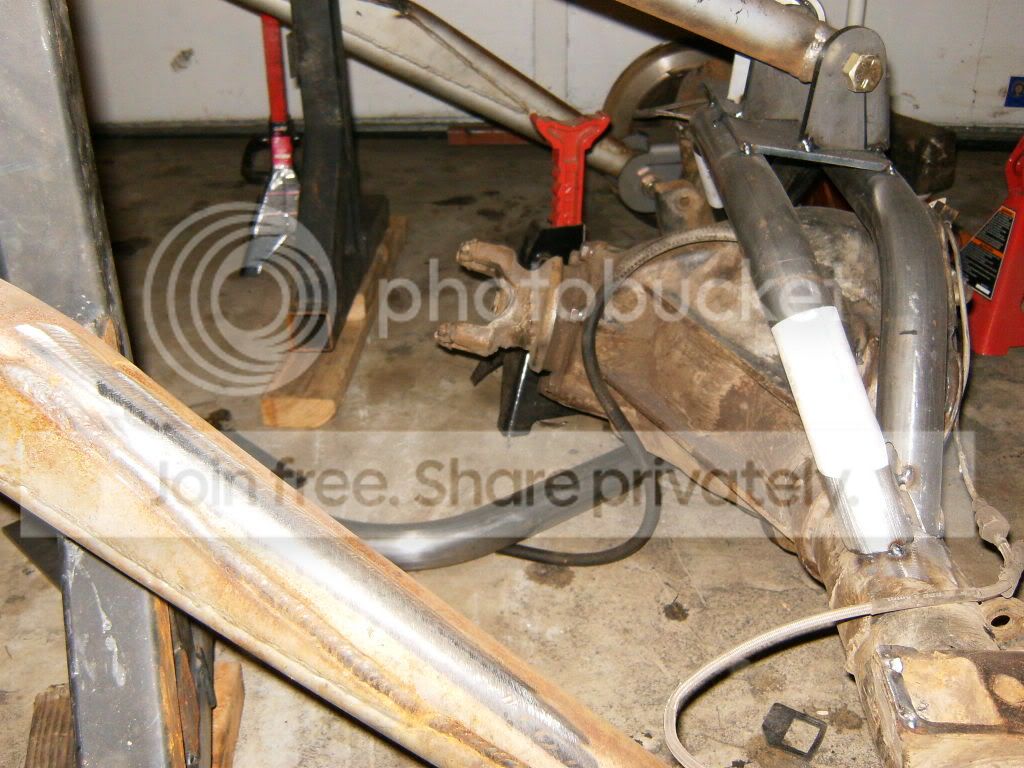

four link rear with bushings at axle upper heims lower 3" ballistic joints. links built from 1 3/4x.250 DOM with chromoly upper triangulation and 3/16 plat between

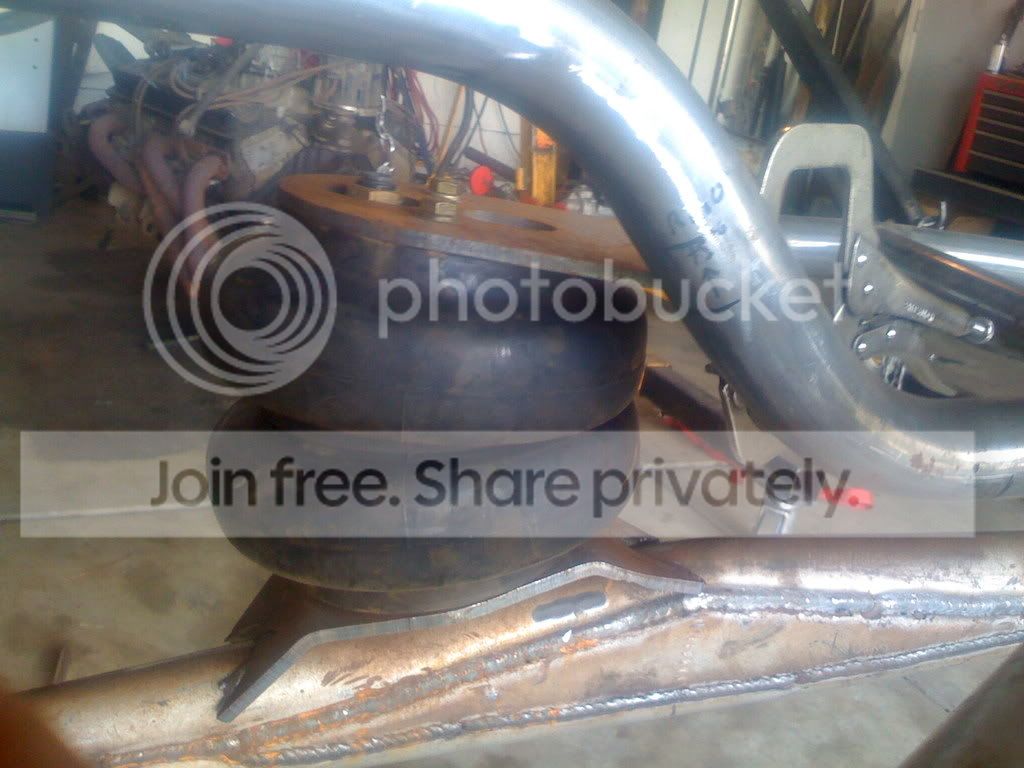

rear suspension is bags right now but i'm having fitment issues...to be continued
front is radius arms with all the same materials as the rear

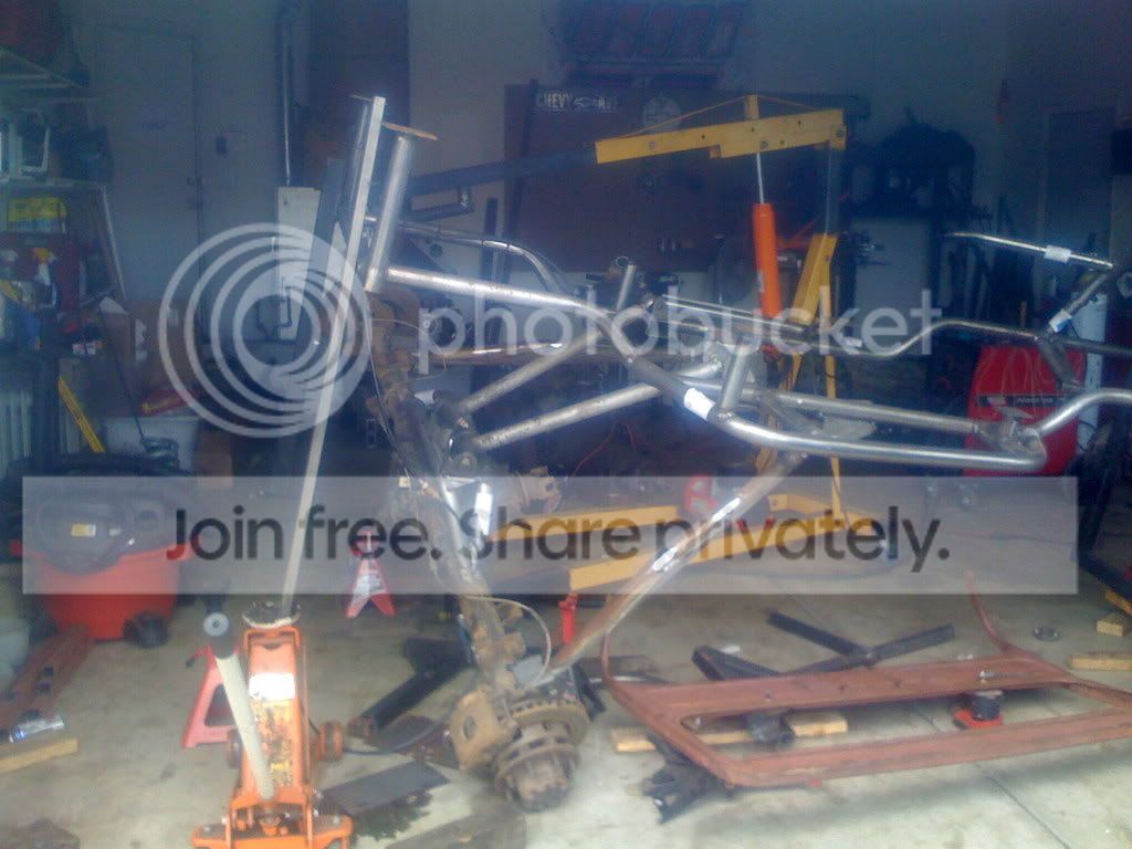

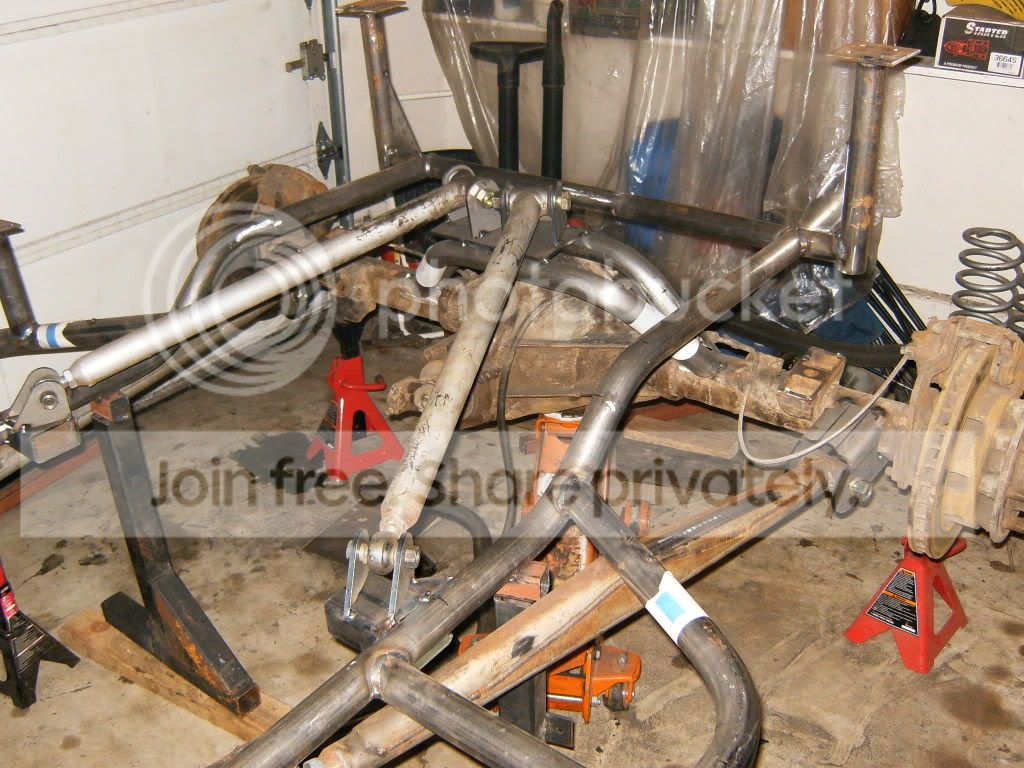

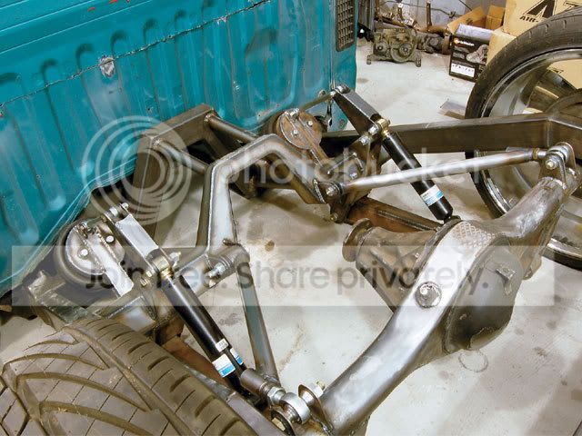

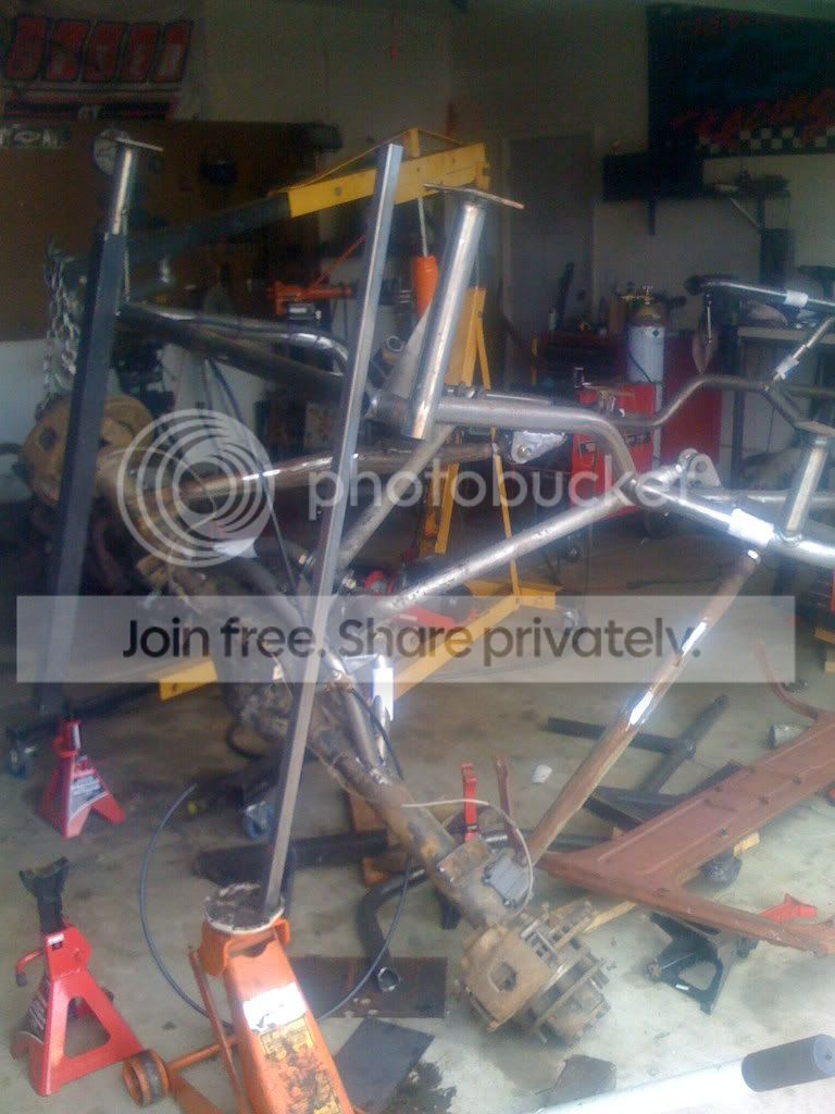

my buddy is coming over today, he is a low rider builder, owns twisted minis, and we are gonna work on a bell crank design to get the travel and twist i need out of the airbags
got my airbag situation pretty much solved, i'm going to start working on the crank bell (hinging suspension) tomorrow when i get some tube

for those who don't know what a bell crank suspension

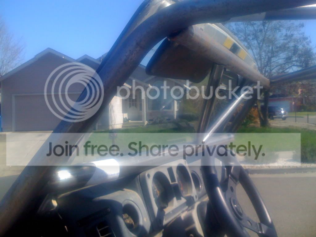

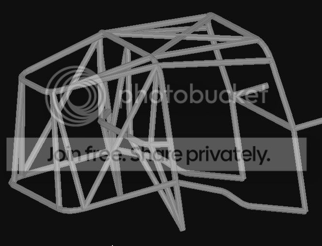

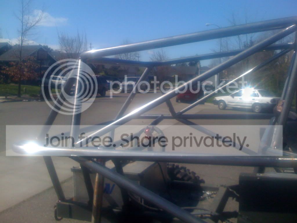

hey all, haven't had much money or time so i haven't go much done lately. i got the body back so i can remount it/finish mounting it and start building the cage. next prchase it going to be either some suspension parts or a transfer case. here's a quick cage idea i came up with last night, a little overkill, i'll be shedding some bars off of it for the final product...

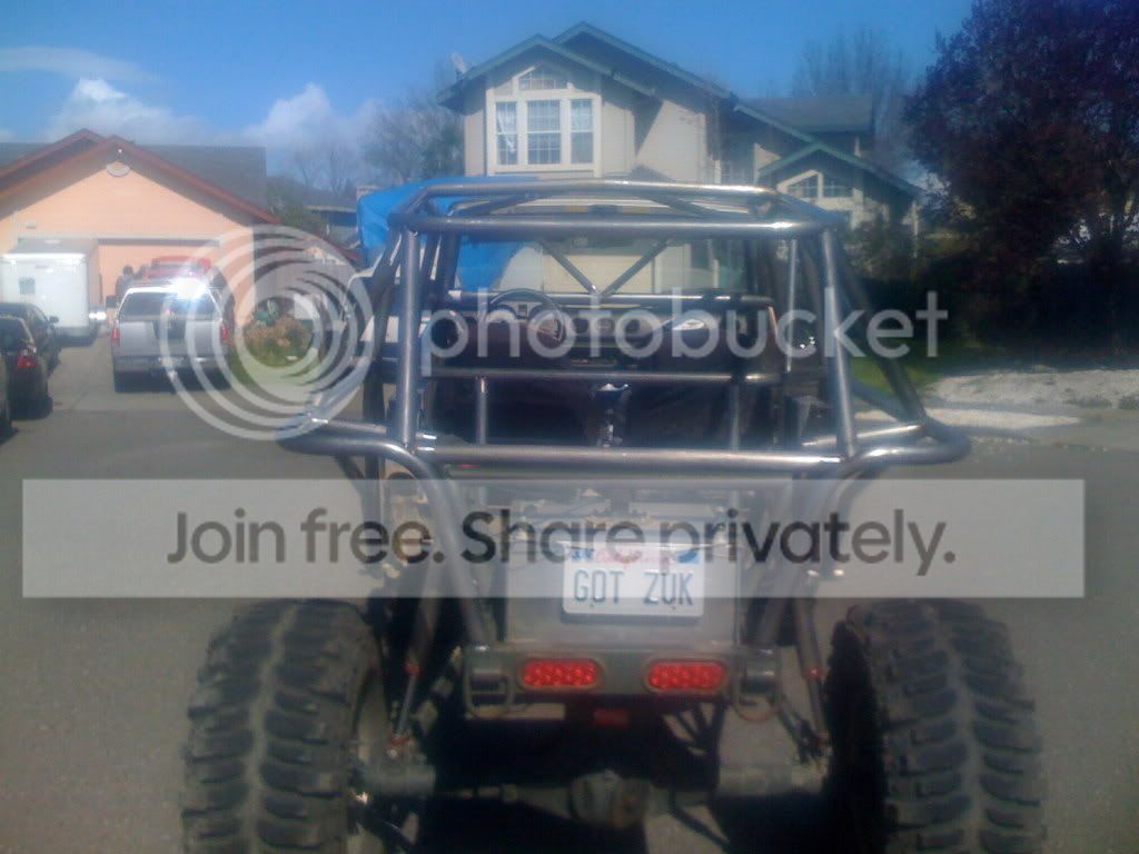

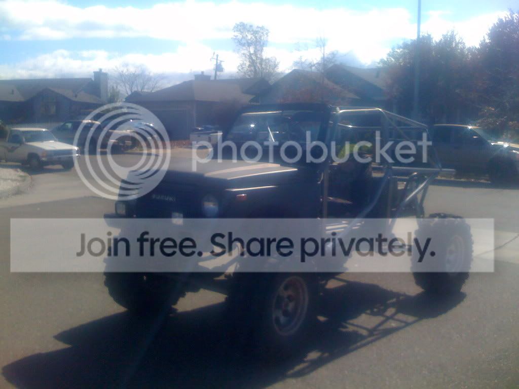

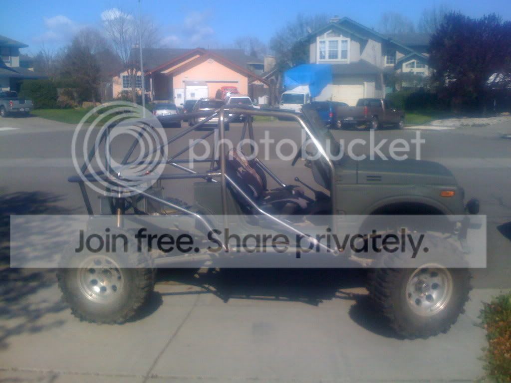

just finished up an exo cage for a sweet little samurai also...
