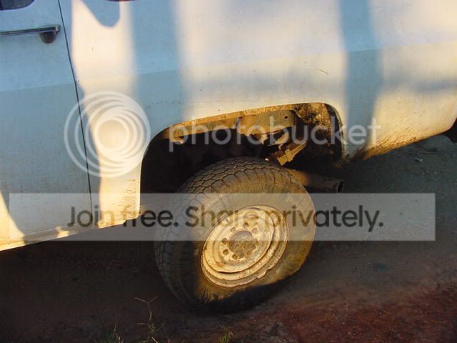

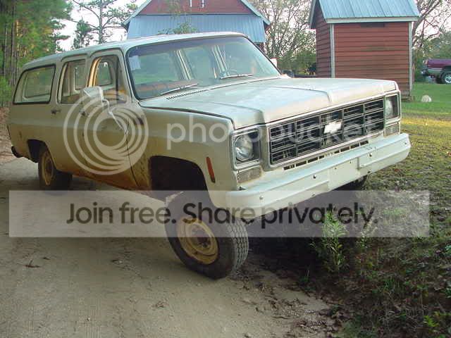

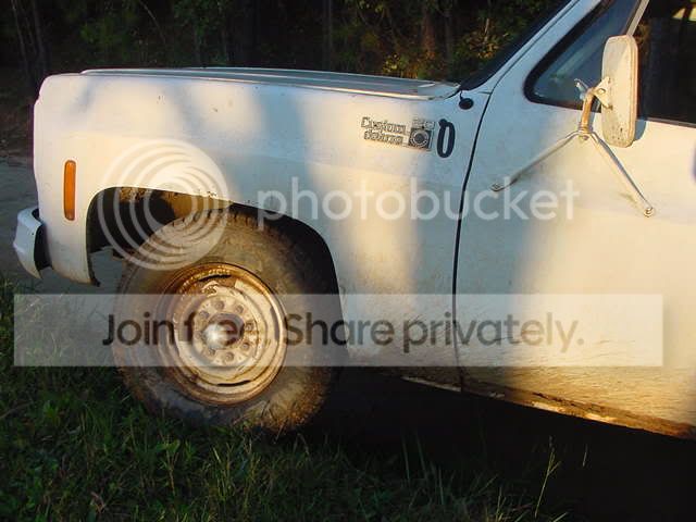

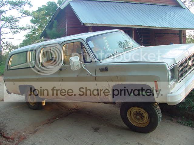

thats right yall, I felt like a looser today flexing with my poorly lubricated beast... but I guess its the limits of what a stocker will do, because I firmly planted the bumpstops :laugh: ... this is embarrasing, but here it is guys..
Well....it's higher than the curbs at the mall. :D
