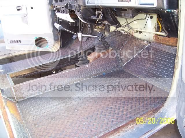

Check out my build thread in my sig below. Go to post 450 or so and start lookin at the pics. All you need is a welder, a vice, and a grinder with lots of cut off wheels.
not sure who did this...but i have this pic saved...i really like it
