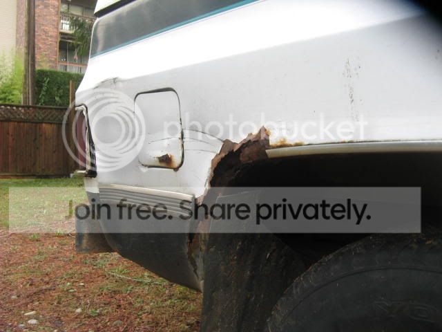

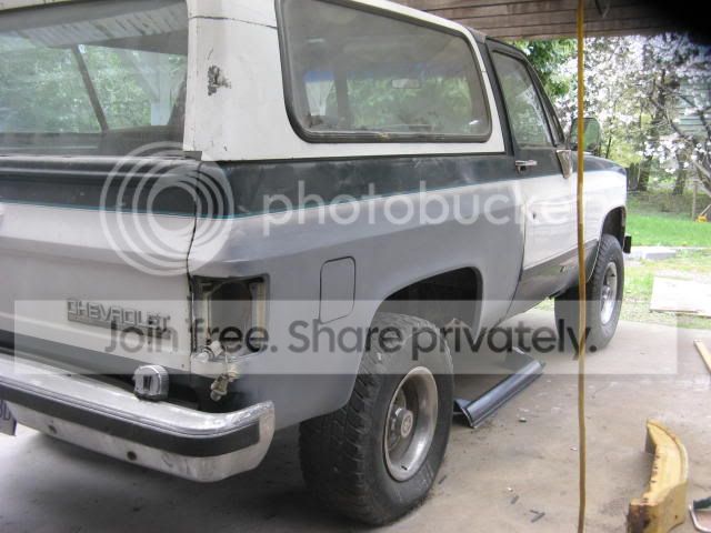

OK...other side: Before pic
nasty stuff cut out, inner wheelhouse repaired, three coats of rust paint.

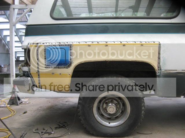

Multi-part patch panel, including a fuel door assembly.
Roughed out and primed for now.

So Rene, did you spot weld until you had one complete bead and grind down? Or was this just like the last pic, with the spot welds ~2" apart, hit with the grinder and then a layer of bondo used?

I finished the welding with a tack every 1/2" to 3/4" or so, then gently buffed them down with the sanding disc on a grinder. You don't want to re-heat those tacks to blue or red again as it'll cause even more distortion. The majority of those tacks burned through 100%. not a single one broke when i sanded them down. The floor patches will be done similarly, but right up until I have 100% weld coverage.
Then fill, sand, prime...repeat once so far. There are a few areas that appear good to the eye, but my hands tell me different so I'll have to go over them again. Max fill thickness is somewhere around 1/16" which is fine IMO.
I did prime and paint the backside of that patch panel I made, plus the inner part of the bedside on both sides. It may not last forever, but it should last a good long time.
