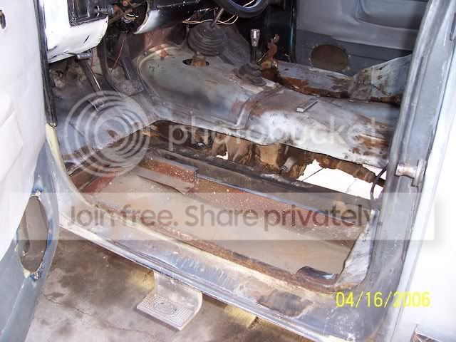

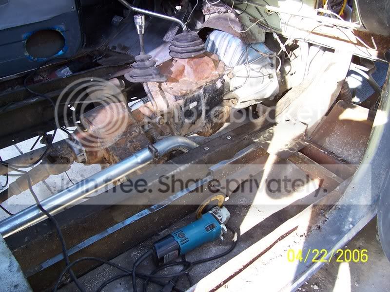

drivers side
passenger side
I will be watching this, my drivers side outter rear seat mounting point has rusted through and torn. It seems to be just that spot. I was planning on cutting it out, getting a patch piece from a donor. drilling holes in it and stitch it in. Then seam sealer and POR-15. Never done anything like it before but sounds good for a trail truck.
I didn't want too pay the money for the replacements, so I formed and bent 1/8 flat steel into the floor. It was tough but worth it in the long run because I ended cutting some out and forming a Stak into the floor. That 1/8 made for some good welding material.
