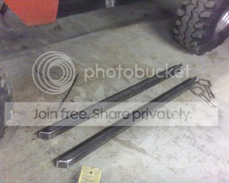

got my sliders built and mocked up on drivers side. Tomarrow hope to cut and inlay
