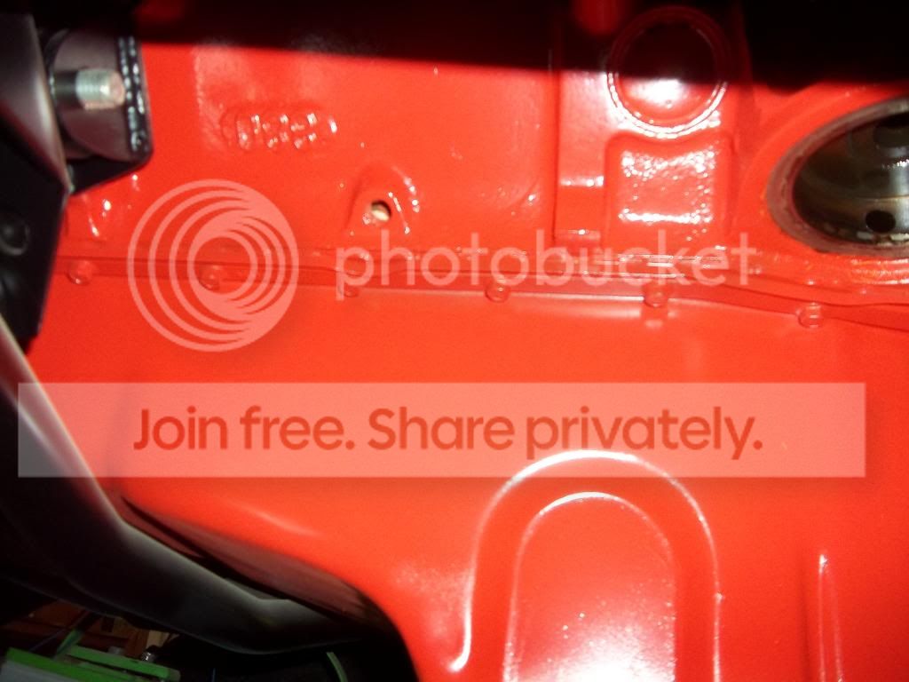

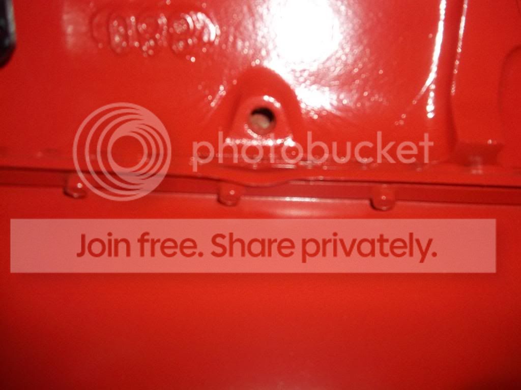

I'm such a nice guy... just went and took a couple pics for ya.... here's where they are on chevys.... just above the pan, about 1/2 way down the block on each side... they are NPT plugs, not bolts... obviously mine have no plugs in them...
I don't care how many times you flush it, if your not pulling those, your not getting the sediment out of the block.... ESPECIALLY if your continuing to get lake water out... I'll bet when you pull the plugs, there's so much sediment in there, no fluid comes out... just keep poking it with a screwdriver to get it flowing...
