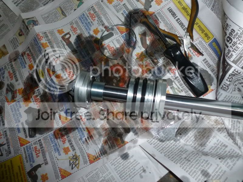

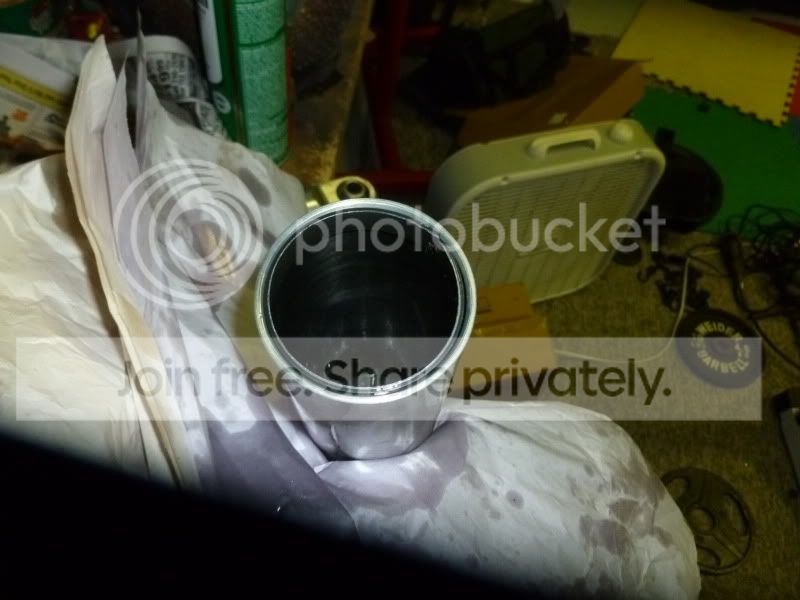

Disassembly was surprisingly easy, It surprised me. I basically read the first step and went outside to pull them apart. I think It will harder to refill them

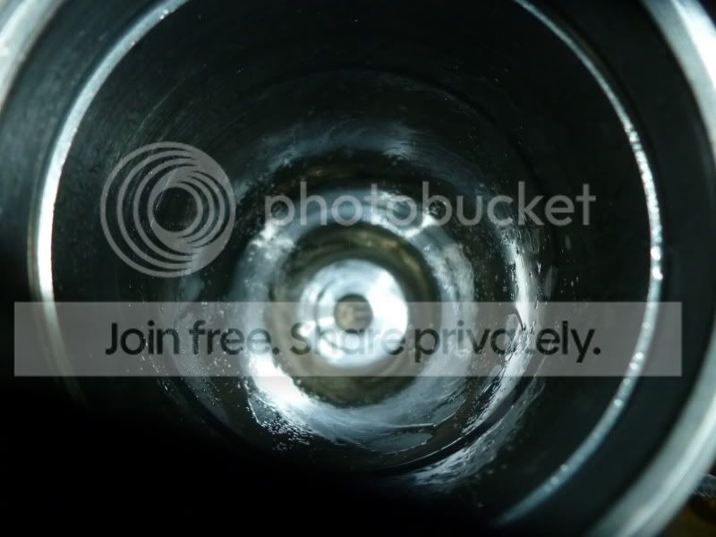

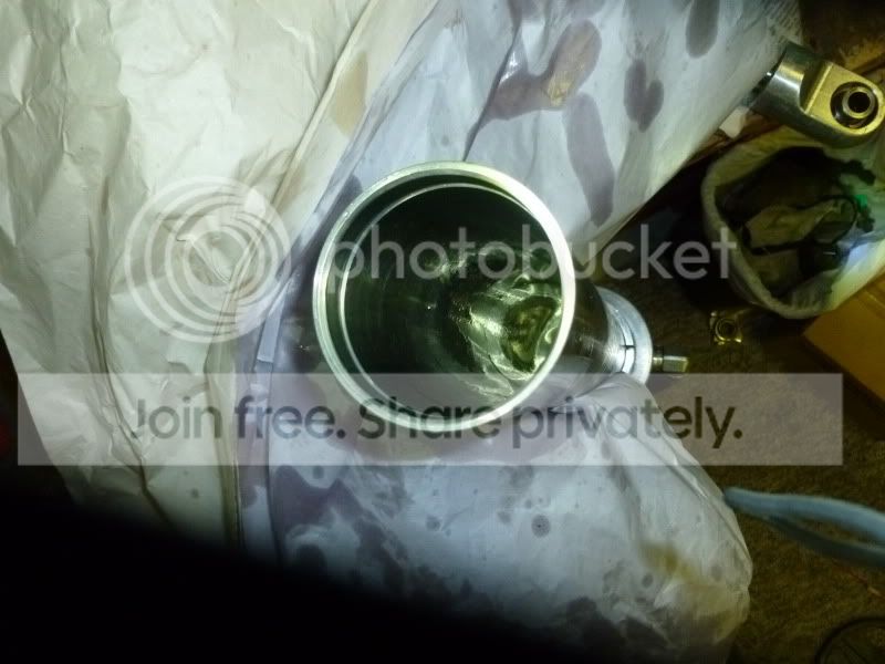

there appears to be an ample amount of metal shavings
Piston seal looks fine to me, I've seen complaints about these before
Upon inspection doesn't really look like anything is wrong. I'll find out after I measure everything
