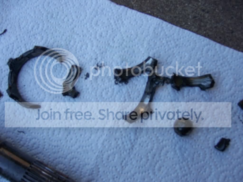

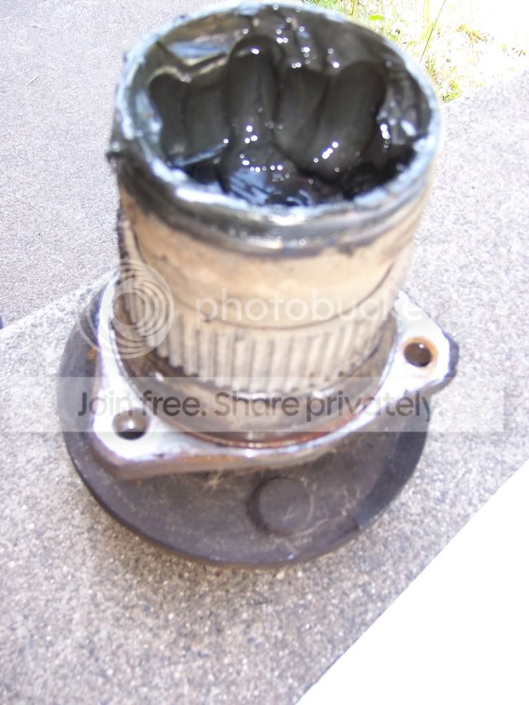

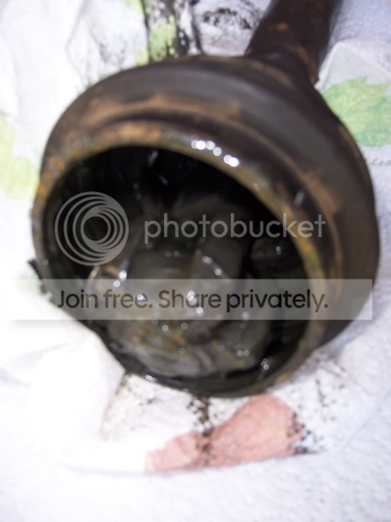

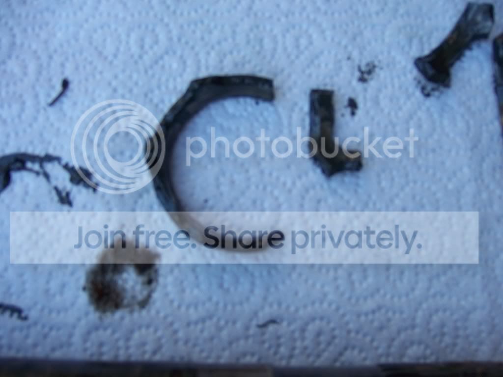

I don't see the point in buying a new cv axle (260 bucks:eek1:). Is there anyway I can rebuild it? All I need is the two rings that are broke in the pics. Both shafts are good and I have all the bearings. Boots are also good.

Those definitely come with CV axle shafts. Ask me how I know. I put a HP 44 under mine though. You can replace your CV shafts with normal ujointed D30 shafts out of a 96-01 Jeep Cherokee (not grand cherokee). They have the same size ujoint as a D44 and are a direct replacement. You will still have CV driveshaft though (which isn't awful). I would say swap the whole axle but finding one with 3.73 gears (V8 ZJ) is PITA. And it is still just a D30. It is a good axle for up to 33" tires though.

You are actually lucky in this case that it is a ZJ with the CV front axle shafts. On a u-jointed axle shaft it's not uncommon for the yokes (ears) to spin around once the u-joint is broke and bind up inside the knuckle which best case only locks up the wheel. Worse case, and I've personally seen this several times, is that it breaks the ball joints knocking the entire wheel assembly off the vehicle. CV's really can't do that, but they do usually break easier than the 297x/760x u-joint.
Best advice is to keep the wheels as straight as possible when down in a rut or between rocks. The more angle in the joint (CV's or standard u-joints) the less total strength they have.
