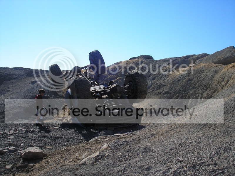

My old rig at the hammers onm 42" tsl's-
qjet 350/465/203/205, 60/14b det/welded. 5.13's. Warn slugs. stock spicer 35 spline outters with 5-806 joints. 1410 yokes at both diffs, highangle 1350 cv's at both t-case out puts. Never broke a thing axle related. :D
