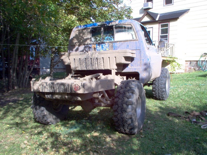

I have less than 10" of front overhang and less than 18" of rear overhang. The rear bumper is 37" off the ground. It's got a flat belly. My plan is to move the rear 64s under the frame, run another 1-2" of lift, put 44s on it, and put a Chevy 60 in the rear. It'll do anything I need it to do yet still be street legal unlike a buggy. This thing turns so much better than my longbox pickup and the "no corners" on it really helps. But it's still not enough for the really tight trails we've got around here (skidder trails turned into ATV trails) and 4 wheel steering should take care of that. I just need to find a 4.3L and come up with the money for some Longfields for the rear axle.
Ya it is prolly not necessary but a boy can dream:D . If I had the tools time and money it would be linked front and rear, prolly run an ORD/FOX tube chassis? 4 seater of course:D . Here is how she looks right now.
