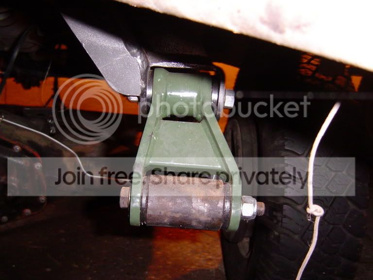

The ford 57"ers come in 2 1/2" wide in the 2wd and 3" in the 4wd, and some f350's. I used the 3" wide ones with a ford front hangar, which I had to weld on, and a custom offset shackle b/c the front ford hangar puts the spring closer to the frame than the chevy hangars. I made a lot of posts asking questions, seach for "offset shackle" and "homemeade shackle". heres a pic of my offset shackle I fabbed:
Also, I think that most who have done this have re-drilled the spring pack to move the center pin back about 1.5". I was going 1-ton at the same time I did the spring swap, so I drilled a new hole for the center pin in the spring perches I fabbed. The new hole was 1.5" forward of center, which moved the axle 1.5" to the rear. The chit looks good.

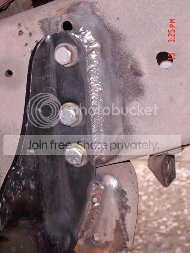

Heres the ford front hangar, I bolted it up to the frame using one of the existing holes, then I tack welded it on, drilled the rest of the holes out in the frame, bolted it up, and welded it the rest of the way.
i think the truck im gettin them from is a 2wd i dont remember. for 10$ ill make them fit. i remember seeing your post along time ago. i like how you make those shackles. i have some really long lowering shackles i plated up and beefed to work. my fords will be like poohbairs, flipped backwards for the extra wheelbase. if i have to use a ford front hangar ill try to splice it to fit how the chevy did so i wont have to mess with my perches or make offset shackles. i wana keep my springs as far in as possible. what i would really like to do is inboard them. but i dont have the money or time right now to box the frame
