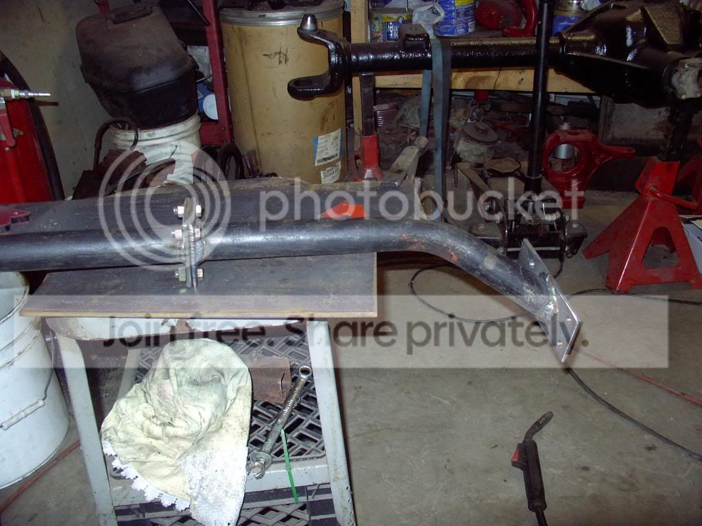

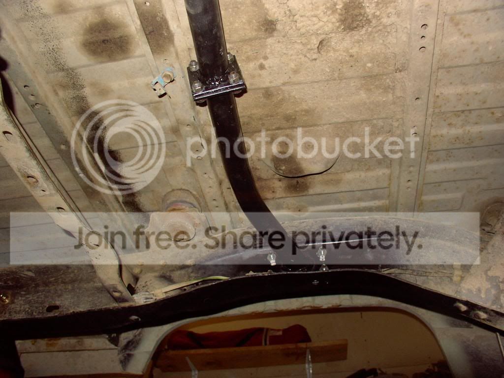

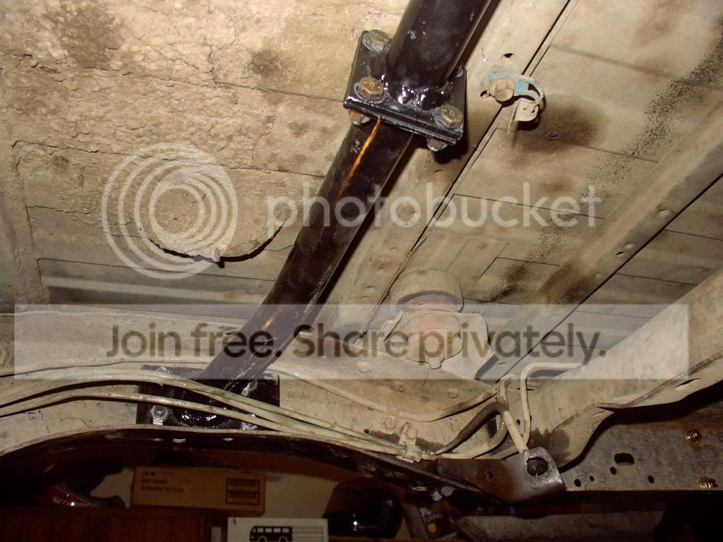

i fabbed up a tube mount/crossmember to stiffen up the frame and mount the shocks inboard straight above the axle, like the old dodge trucks were! then ill mount them on the axle just inside the spring pad.

cut some fuel line hose and put around all those lines to help keep vibration from destroying them

I would recommend placing the lower mounts a little in front of or behind the axle, to help prevent axle-wrap.
i have the ruffstuff antiwrap sprig pads and im gunna try it this way first and see how it works! i dont wanna be wacking the rocks any more with my shocks!!
