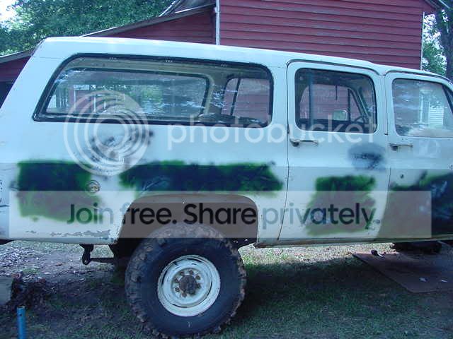

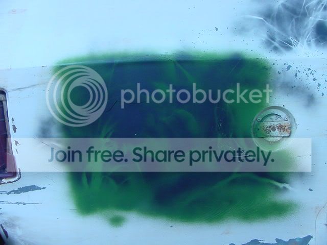

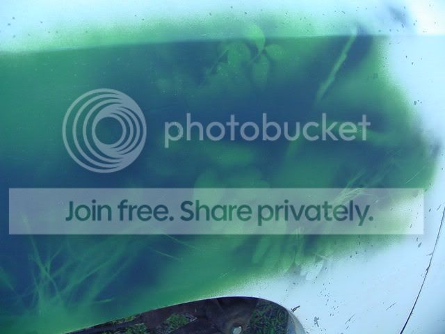

me and a buddy finished off the ford tower project and played around with some paint testing...
that's all I got done today :p:
that camo actually has potential. never thought of painting like that(green first and use the shrubs as the stencil then paint darker color) pretty rad.

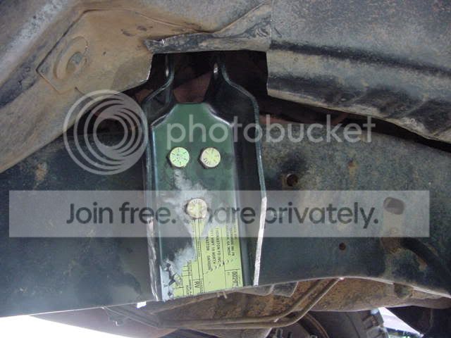

I would have left them longer and moved them farther into the engine bay but that is just me. If you are not flexin a lot and mainly running mud it should be fine:D .
Ira
Ira
they have 12.5" of travel, and I set them to have 6" of rod showing, so it has a very slight bias toward droop over compression...
johnathan said:
Where do you get the Furd shock towers?
Ordered them from the Ford Dealership in Thomaston. Any ford Stealership can order them, I'll get you the part number if you want.
