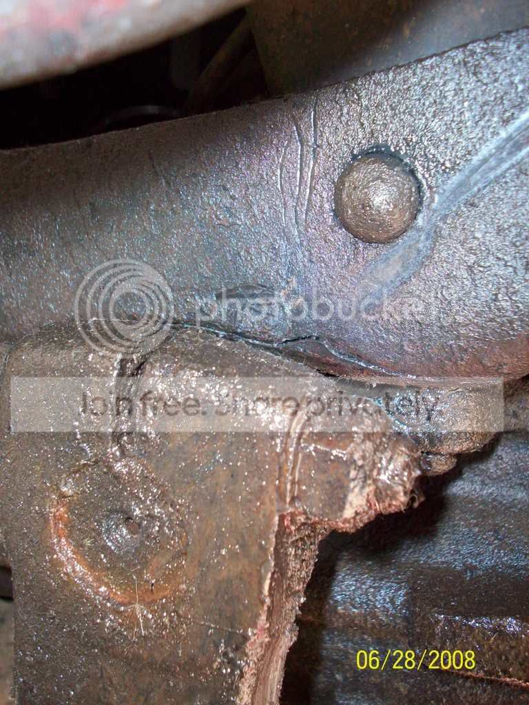

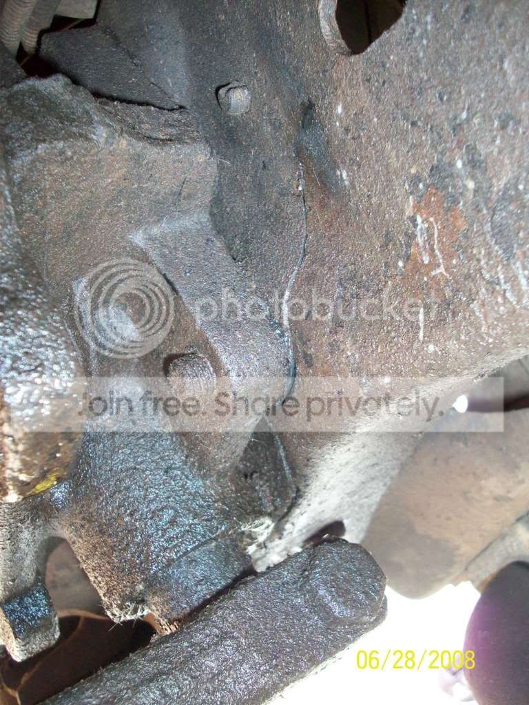

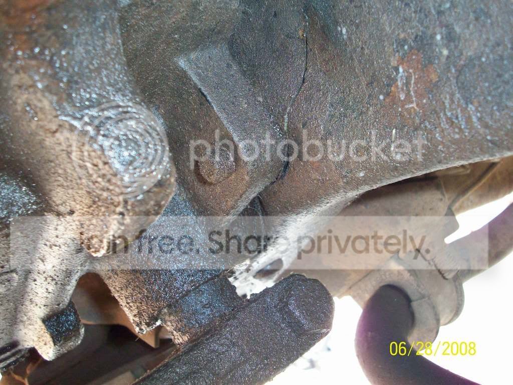

While doing the left to right method everything was moving....Even my steering box. Then i seen 3 different cracks all at the steering box pretty much lining the bolts. With minor effort you can see atleast one of the cracks flexing.
Are these cracks the Main reason for the death wobble? i'm going to replace the front bearings that i know are bad. Do i need to weld the cracks before i put her back on the road?

Pics! Without seeing the damage it's hard for us to give you pointers... if it's not bad you could weld it up with an ORD weld in frame brace along with a bolt in brace as icing on the cake but if it's beyond that it's time for some serious work...

Pics
not good..... you have your work cut out. Stop driving that truck until you get that fixed.
With the crack running along the bottom edge of the frame rail like that you are going to need some help from someone with good knowledge of metal fatigue and welding, the patch kit we have been discussing isn ot going to band-aid that one so easily

we've seen worse...
you'll need to repair that before any additional support can be added.. and yeah sure, pull it all apart, clean the hell out of the area. grind the area clean, v-grind the cracks and stop-drill em... weld up the cracks, grind smooth where need be, put weld in patch kit, then add bolt-in..
dont just weld it up, assemble and drive... it WILL fail at some point...
Remove the steering box, and you'll see even more cracking. When you see cracks easily around the box it's riddled with even more behind the box.
Each crack needs a small hole drilled at the end of the crack, then prep each crack with a grinder to make sure you get full penetration on the weld. Grind the repairs down flush, then have a look at the inside of the frame. If you still see cracks on the inside I'd prep them and weld them too...you want to fix those cracks, not just hide them from the outside.
The crack on the bottom isn't good, but the secondary plate with the weld on kit will take care of that area. Make sure the stitch pattern in the instructions is followed carefully or you'll have some seriously ungood stress risers in that area of the frame.
The kit ORD sells is good. They don't make it, but they do sell it for a fair price. Add a bolt in brace after the repairs are done and you'll be back to good for a long time to come.

Whatever you do, take the steering box off, and clean it like the other folks said.
You've got a lot of grease /oil there, and until you get it all off to take a close look.. you wont really know how bad it is.
Wanted to add I prefer flux core for that type of repair. It dig's harder and is able to burn through any rust, oil, etc without trouble. MIG with gas needs a lot cleaner prep.

do i need some sort of clamp to bring the cracks together before welding? because there is a small gap. Or is that the purpose of grinding the crack into a v? so essentially your filling in the crack?
