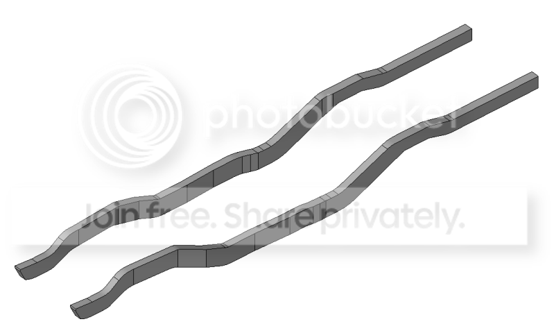

I'm looking for the frame dimensions for later 80 early 90 blazer.
I've searched and found some at www.chuckschevytruckpages.com which helped but there is plenty of measurements missing
Bored at work so I'm making a 3d model of the frame to pass the time.

this is where I left off
