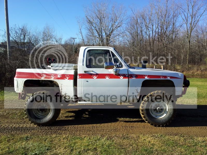

OK... any money I spend is going towards my Blazer.
I recently traded for the below "pickup". I am into it for basically nothing. I want to keep it as close to that as possible.
I am going to use the one tons from my Blazer under it. When I do that I want to add some lift to it. Ultimately want to fit 39.5 Boggers.
How can I get 4" of lift as close to free as possible? No body lift.
I don't understand. Can you just use the lift on the white truck? It has something, not sure what lift though.

Sure looks like there is some kinda lift on it.
52s in front.
