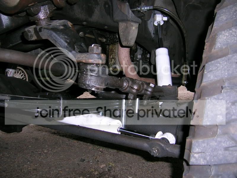

I went and did some looking at the shop and snapped a ton of pics. I actually see some things that are bothersome. First, I'll post pics of the steering arm/draglink/pitman arm. I would say that the steering arm is definitely one for a lift correction but what do you guys think? Also, do you think this pitman arm has a drop in it or that it's a regular stock one?(FirstPic)

I would take off the corrected steering arm and put a stock one on it, get shorter shocks, and call it a day.

Your steering arm (the one bolted to the axle) is for at least a 4" lift. The stock arm curves down not up. I found this image to illustrate:
I don't know for sure if your pitman arm (the one attached to the steering box) is incorrect or not. But, when you are going straight I believe it is supposed to stick out straight to the drivers side. If it is not then you need to shorten, or lengthen the drag link to achieve that result. My guess is that your drag link is too long since your pitman arm is incorrect.
That is my best guess. good luck.
Good news, swapping in a stock steering arm and shorter steering stabilizers fixed the limited turning radius problem. The axle is still off center slightly but from looking around under there, I think the frame might not be exactly true and causing it (I hope not). I'll need to measure the frame rails then the diagonals to see if that's the case. Thanks for the suggestions!
