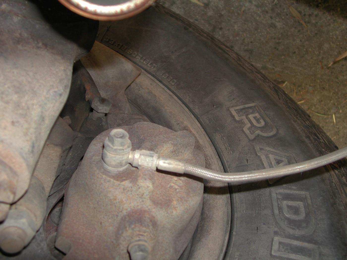

I got a set of braided hoses from Inline Tube.
They have the round fittings.As long as you install the supplied copper washers you should be fine.
I installed mine about 2 years ago and they have NEVER leaked.
/forums/images/graemlins/thumb.gif
Thanks Bob, I ended up buying a set of Earls from the local speed shop near my work. Cost me about 50bucks a side but the frame mount piece is gonna work great with my exsisting hole in the frame.
Thanks for the photo /forums/images/graemlins/thumb.gif
