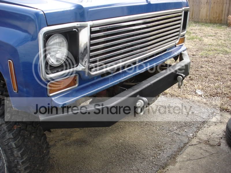

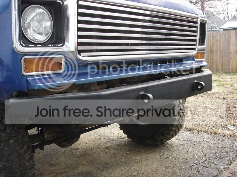

So I fabbed this bumper a few months ago...

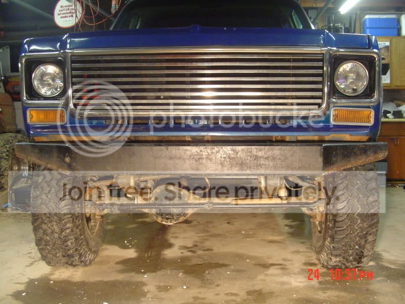

And last night I got bored and had access to a torch and welder... So I cut off some metal...
Its going to be getting shackles and paint, but thats what I got so far. Still need to grind welds and cap the ends, but you get the idea.. pretty much my first welding project.

Looks good. My buddy and I are going to start on mine soon.
Is it just me or do i see a drag link on the passenger side and a steering arm on the drives side? How does that work?
I think he was too lazy to remove the d-side arm after he converted to crossover
I actually didnt want to mess with removing it when I converted to crossover. Its not in the way of anything. Any real reason I should bother with taking it off? The less work I have to put into that axle the better. I didnt convert to full high steer when I did cross over as it would stress out the ball joints too much.
I plan on adding some sort of stinger to it in the future.

sure! but shipping would kill the deal, as that sucker is 3x6 .250 wall box, about 7ft long when i started. :D
