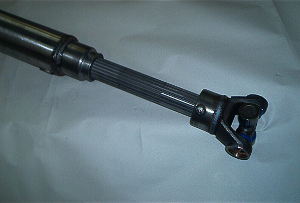

Having a longer male spline in the stock configuration is useless if the slip Yoke isn't longer as well. IIRC when a LONG slip driveshaft is made the male spline is now part of the slip Yoke (that bolts to the axle) and there is a long female slip piece welded into the driveshaft so that the male spline goes inside of the driveshaft when being compressed.
This is what i'm talking about.
