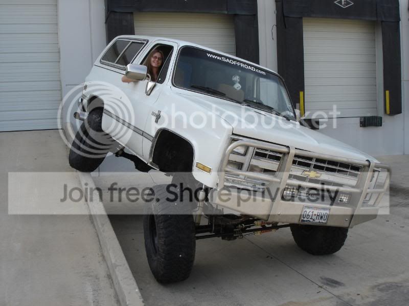

i dont know. i completely ground mine off and didnt really seem like i got that much out of it. only one way to find out
mine can do this and still be free
