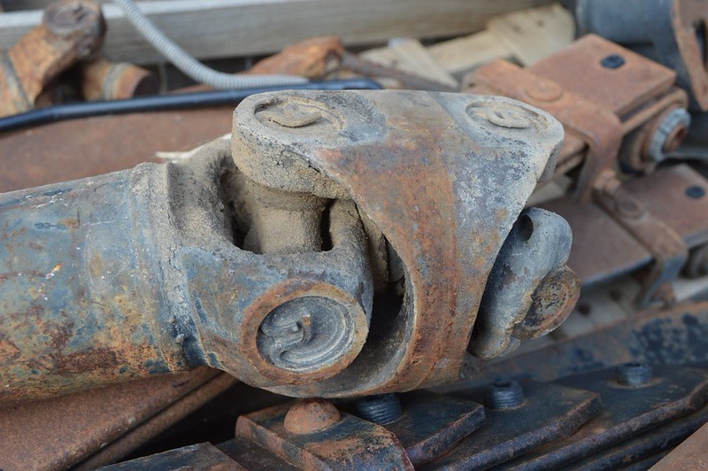

The one I need uses 5/16" bolts that thread into the CV portion of the joint like this one.
I have a sm465 with figure 8 adapter. After looking at their site it looks like I need the 24 5/8 length one, but I can cut down a longer one if that's all you have.
