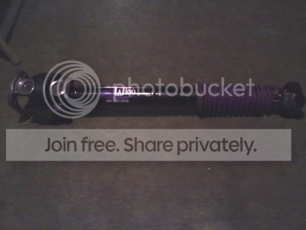

Tattons driveline does real nice work real cheap, i bought an over 11 inch splip shaft in 1350 that was ground for a steeper angle with a cv on one end for under 250 shipped. Its turned my 39s and my locked 60 just fine. I know its more to spend but until you buy what you need plus new joints and its even balanced....pictures a little misleading since it has a conversion joint on the axle end in the pic.
Numbers on the shaft...lol...ask for curtis. Quality service and pretty fast shipping . He uses spicer joints and has the u bolt yokes in stock.
