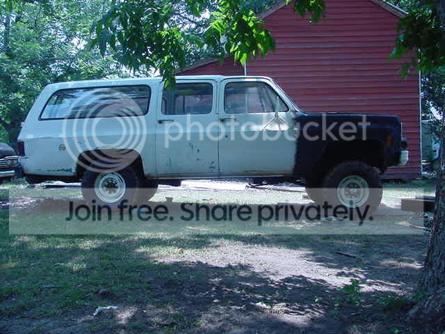

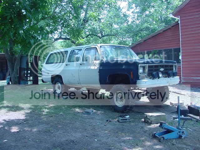

Well guys, it seems natural selection has brutally failed, and nature is still stained with my genes, because I survived the front part of my lift :bow:
The 4" RC springs and zero rates actually netted me 7" of lift in the front, since my old springs were so saggy. Hopefully the rear echobit will pull it up close to level.
Man, opening the hood just got alot harder!!!!

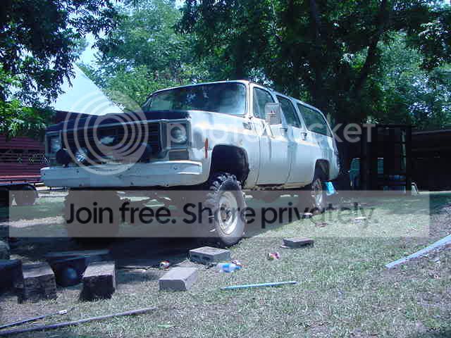

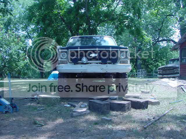

Just the hard bit to do then!:D
Urmmm......those blocks on the ground.
They're not your 'axle stands' are they?:eek1:
Please say no!
Please say no!
You should see the "before" pix ... check his other threads. The boy is enthusiastic, if suicidal :rolleyes:
