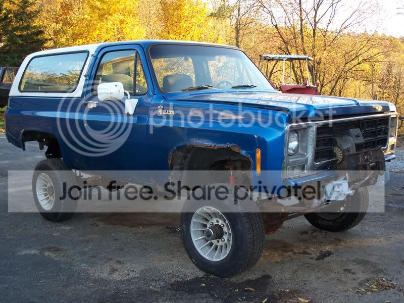

My 8274 is mounted to the front of the frame via a Warn winch plate.

thats not bad at all, my mount plate looks similer to the one on the blue blazer. i was thinking of makeing a bumper out of 1\4 inch metal the whole front of a blazer paintin in with rustolium. and putting heavy wall tubeing to go up to the top of the hood. thanks for the answers, i look forward to seeing more pictures of winch mounts on k5's.
