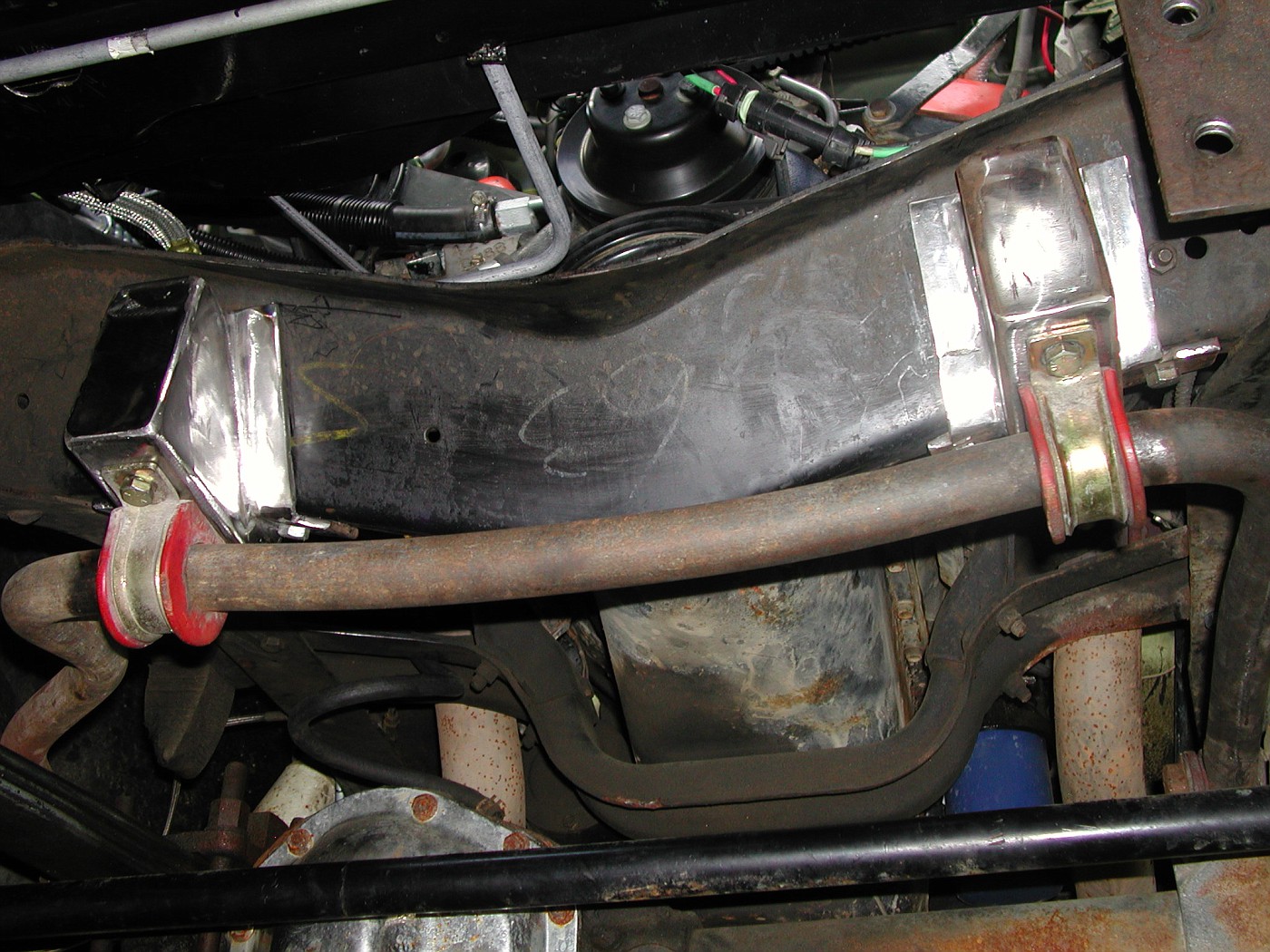

Also.....if you're handy (and it sounds like you are) just pick up a swaybar and upper spring plate mounts from a 73+ K5.
Most guys pull them off and throw them away, so the price should be free or close to it.
The benefit is that you can use the ORD Swaybar disconnect system with it (good road manners when attached, good flex for wheeling when disconnected)
The only challenge is that you need to weld on a couple of custom made pivots to your engine crossmember to hold the bushing assemblies. It's not hard if you have a welder and basic metalworking tools.
Don't buy the Hellwig kit....save your money for other things. You've got a 1st Gen so you're gonna need all the money you can GET!!! :)
Like Greg said,I used a 2nd gen sway bar.
Here is a link to what I did.
http://coloradok5.com/forums/showthread.php?t=128455
