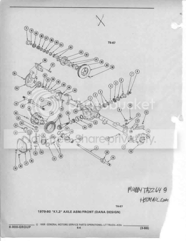

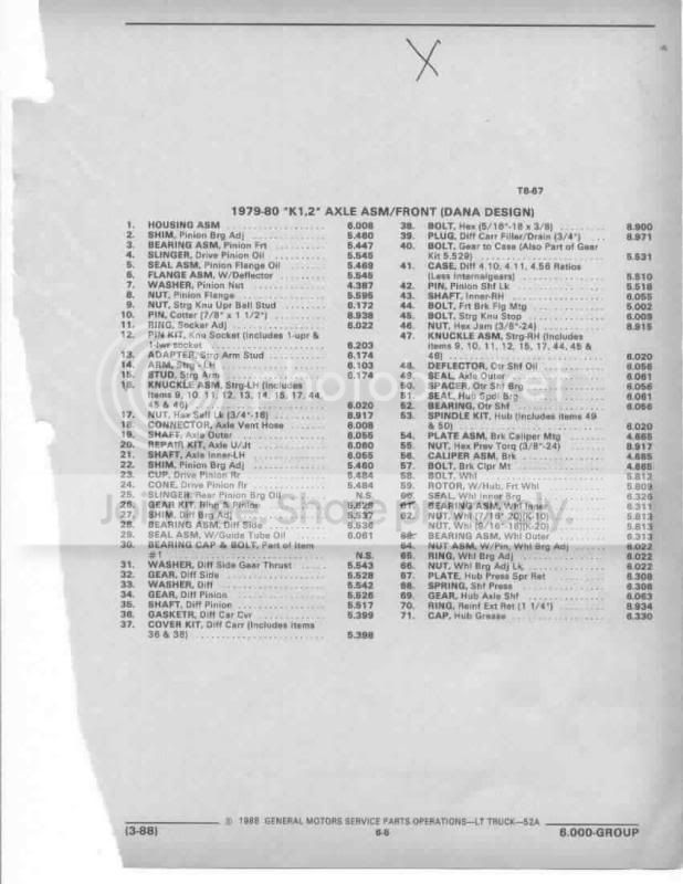

Mine looks like the bottom one.Once I take the first snap ring off and remove the drive flange (cuts inside and out to catch)then theres the spring...which doesnt come out...Nothing online showes MY axle there all ford,jeep and dodge it seems..
Hmmm not sure what that spring would be caught on.
Here is a drive flange IPB.
