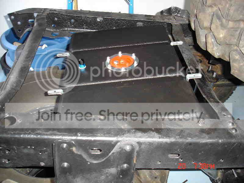

I'm currently mounting a 16 gallon from summit. Moving the rear crossmemeber forward to mount it nicely. I started it last night and will finish it tonight. I'll try to post some pics. below is a pic of what it looked like before i started. The tank is going to sit between the frame rails and still doesn't hang down as low as a stock blazer tank. Its a trail only rig, so i figure if i need more fuel for a long trip I can always mount another tank on the flat bed and run its output line to the other tank. For 120 bucks with foam in it, its not a bad deal. its another 25 for the mounting straps, but you could make your own cheaper.

here's my set-up I finished tonight. Just need to drill a few more holes in the frame to bolt in the rest of the crossmember.
