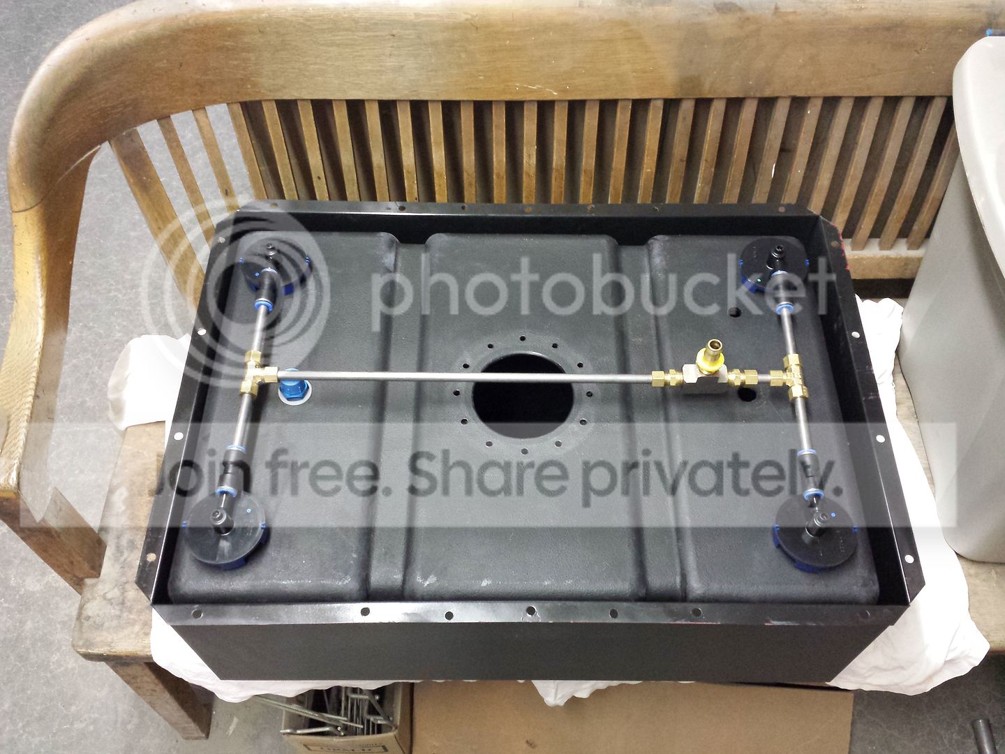

I have a Walbro pickup in each corner of the tank, going to a central puck, and from there to a side port on the tank (custom design w/ external pump)
Neat idea. Do you ever have problems with air in the fuel line when low on fuel and you uncover one of those ports on a large tilt? Or are you carbed?

My cell picks up in the center just off the bottom of the tank. Mine is a really tall rectangle though so even if I get down to a couple of gallons it can slosh and still not go "dry" on the bottom.
