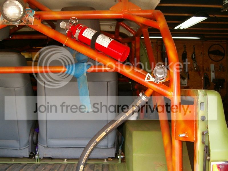

I run type 2 marine fuel fill hose on the CC.. it's stupid expensive... and quality... about $10 a foot...

I'll call the marinas on monday. My old hose is still good, it is just too short to fit where I want to mount the cap/neck assembly .

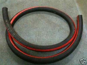

it'll more than likely be Shields or Trident brand... I prefer Shields, but not much difference..
this is the stuff i run shields type a2, wire reinforced, cg certified, yada...

Extend your end that has the gas cap with metal tubing and then your hose won't be to short.
