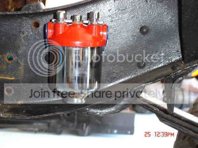

I just mounted it inside the frame rail behind the rear springs front hanger. I guess it should be fine there... I'll post a pic in a min. It is a stock pump. I also have a clear screen filter to go between the pump and the carb.
