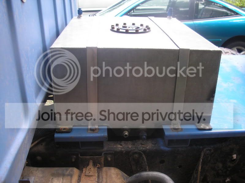

this may be a dumb question. I have a fuel cell. can I run the fuel return line into the bottom of the cell? how much pressure is there on the return line versus how much pressure would the there be from fuel pushing down in from the cell? there are 2 fittings. one I am using for the fuel feed. I have a fitting on top of the tank I can run it too but if it will work the lower fitting would be better for my setup.
this is how I have the cell mounted. I run the feed off one of the lowers. I could run the return into the upper left.
I realized after the last trip out that I needed a return line. The truck stalled a lot and didn't fire right up when I tried to restart it every time. It didn't do that before I plugged off the return line. :doah: I guess its flooding the carb and thats causing the stalling and hard starts since thats the only thing that changed. I needed to get it put back together quickly to make the ride.
I am running a stock mechanical fuel pump off the side of the motor.
No one needs to mention the breather line. :rolleyes: it's already taken care of.
i wouldn't run the return line into the bottom, because the fuel will be pushing out of the tank, and the pump probably wouldn't be able to force fuel in the bottom.
