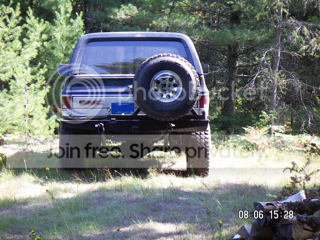

I have a tube coming down from the main bumper that adds some protection to the gas tank. It is angled towards the front of the truck at an angle that kind of matches the skid plate. For traveling in reverse, it should be quite effective. I have never had it hang up on anything wheeling.
This isn't the greatest picture, but you can see it:

nice looking bumper,did u buy that or build it looking for something like it.got any more pics
