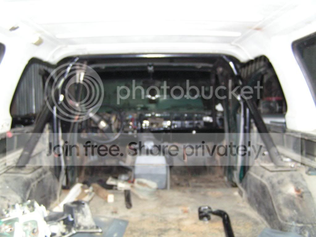

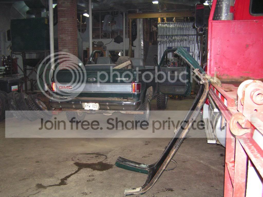

I've done the full vert thing. Experience is something you get after you need it. Having done it I would suggest bracing the door opening. A good bar of some sort between the A pillar and the B pillar at door handle height. If not the cowl and A pillar will sag.
One thing I did right was stake the windshield frame using 3/4" OD tubing about 6" long. I also measured the inside windshield opening in a few key places before making my first cut. Having the 3/4" tubing inside the frame staked it in position very nicely, plus it provided backing for the welding.

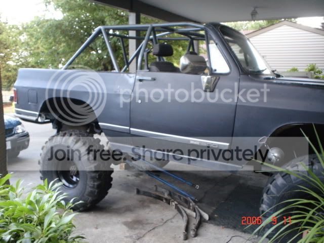

I did have my rockers replaced with 3 x 3 box tubing, but the cowl/"A" pillar was still moving a lot more than I would have liked. I also had issues with the bedsides spreading, eventually I sucked them in and welded them to the roll cage. :whistle:

The final iteration before I parted it...

I love mine. I did the tube trick in the pillar as well. I'm planning to go back and brace underneath, but I'm also going to put a roll bar of some sort in it. I don't want a full on cage like a rock buggy. Then I'm thinking of some kind of bikini top for sunny days!
