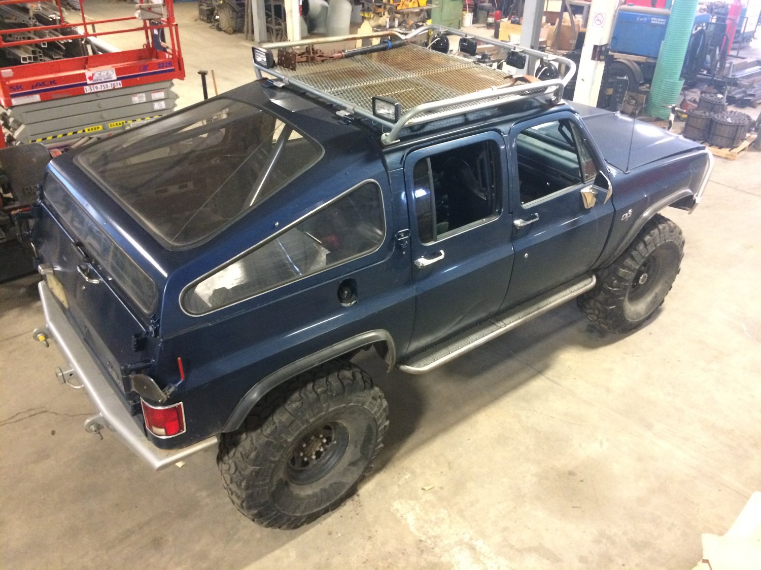

If you're worried about rigidity, you could compromise and just chop the back half off (like @kellyjohn did).
kellyjohn-jpg.230869
That was a killer rig. Wonder what happened to them?
