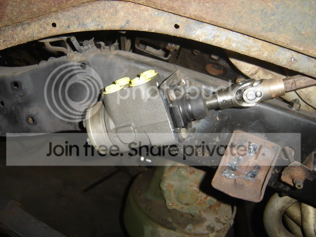

Is this a pretty common setup for mounting a valve on a C channel frame?
If so, there must be very little force on the valve.
That is common. There is no force on the valve, well only what you can apply to it through the steering wheel. Hydraulics do all the work at the ram, there is no mechanical linkage between the box & axle.
