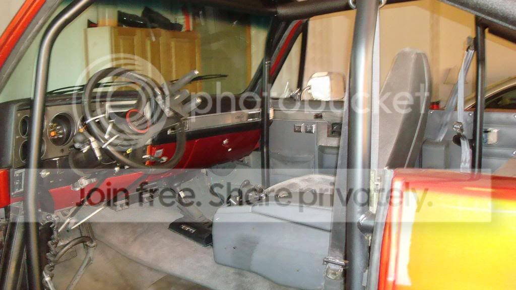

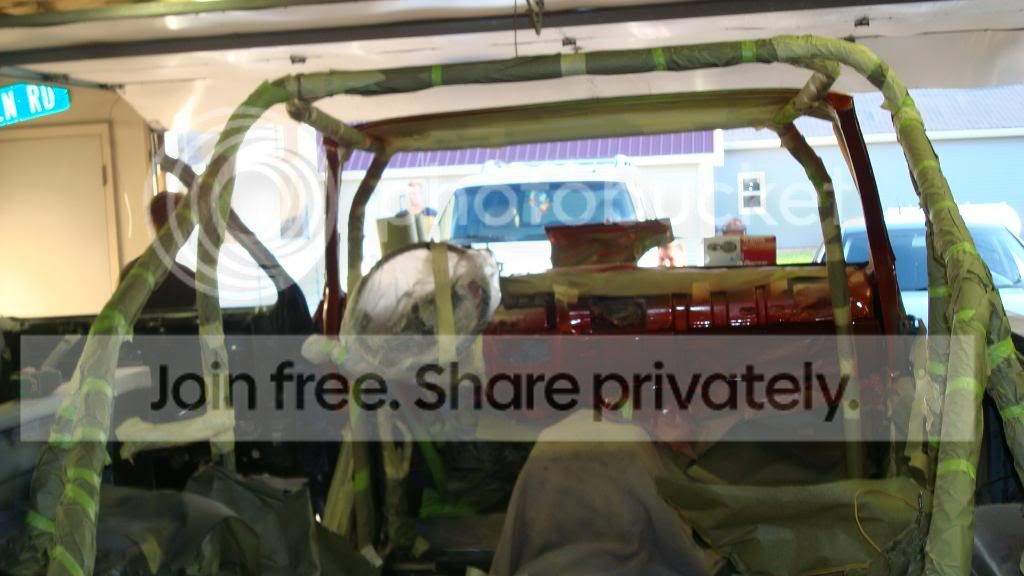

I'm not a rock crawler (although I would like to) therefore I'm not going to flex my truck a bunch. The main reason for not flexing is the modifications done for the wheelchair lift. The frame is modified and I don't want to break it. I put a cage in my truck that has some welds to the wind shield frame and to the B pillars and I can say that my truck is more solid since I cut my top than it was before.
In this picture you can see the cage attach to the passenger B, and you can't really tell but under the masking there is 2 thin pieces about 8 inches long attaching the windshield frame to the cage. Now that might not be a good idea but I haven't broke a windshield and the thin pieces may brake if it flexed and moved that much. I'm no expert on the windshield frame attaching to the cage maybe someone can fill us in more on this but I'm very comfortable with it in my application.
Edit: I guess you can see the driver and passenger in this photo.
The next to kind of show tubing running to the drivers B
I hope this helps and if you want better pictures I could take some.
Good Luck
I have know regrets.

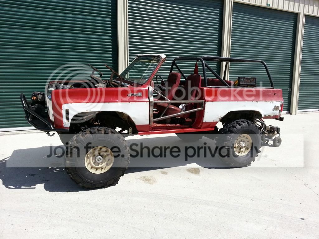

80' Jimmy.... cut the roof off / capped the bed rails / 2" x 4" x 1/4" sliders tied to the cab supports and the floor with 1 1/2 angle and flat plate ( sandwiched )
rear cage was a gimme with the truck from the PO..... going to cap the windshield with 16 gauge and build a new front cage and tie it all together....
oh,,, and ORD tube doors FTW.... :waytogo:
