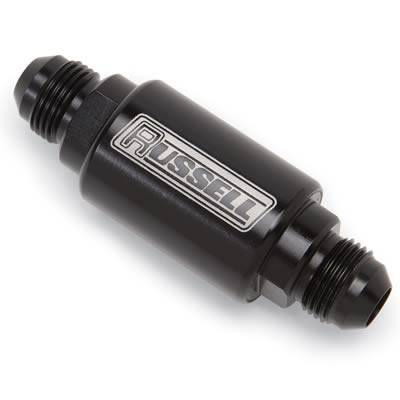

The Walbro pump is placed into the stock in-tank pickup. I have a reusable screen type fuel filter. Like this:

I really doubt that filter you have is rated at micron filtering needed for EFI injectors? Ones like that I've seen let enough crap past to fill a float bowl of carb with crap.
regardless if this is my issue, now I'm concerned
I read it filters down to 40 microns. There are some on Summit that filter down to 120 microns. SS mesh vs. paper filters
:dunno:
should I really change it or am I ok?
If the old memroy still works 40 micron before pump which is like a clear filter used on carbs and 10 micron after pump...
well, the intake pickup has the sock on it
the concerned filter is between the TB and pump
the smaller number the better? Seems almost the other way around looking at some of the prices. Ok
I'm old, I may be wrong... :haha:
Nope I was right...
10 Micron filters are recommended for use as a post filter in EFI systems
40 Micron filters are recommended for use as a post filter in carbureted systems
100 Micron filters are recommended for use as a pre filter in carbureted and EFI systems
Fudge!
Before I buy another one, I found the filter that came with the FAST kit. The only reason I'm not running it.....was I didn't realize it came with one :doah: So I bought a Summit Racing filter. I think that one goes down to 40 microns. Everything on Summit only goes down to 30. Not sure what microns level filter was supplied with the kit, I'm sure it's a good one. I'll try running that. I'll also try squeezing the return line and see what happens. Still haven't done anything about it, found other stuff to take care of. :doah::rolleyes:
